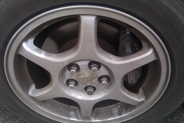

Originally Posted by STi-owns-evo
I have the Hawk HPS pads and they dust like mad.
??? I have used Hawk HPS on many cars,and one of the things I like is that there is almost no visible dust. Also,the dust isn't greasy and it dusts off.
Old Jan 13, 2010 | 11:29 AM
walt's Avatar
Joined: Mar 2007
Posts: 230
From: Palo Alto,CA
Car Info: 2004 STi,sold.
Go for Baer (or GiroDisc) 2-piece rotors.
Old Jan 13, 2010 | 12:09 PM
STi-owns-evo's Avatar
Posts: 3,670
From: East Bay / Pomona
Car Info: '02 PSM WRX
The dirtier pic is about 4 months, with some clean parts because the wheels were recently rotated at America's Tire Co.
The cleaner one is about 3 weeks.
I wish my pads didn't dust.
