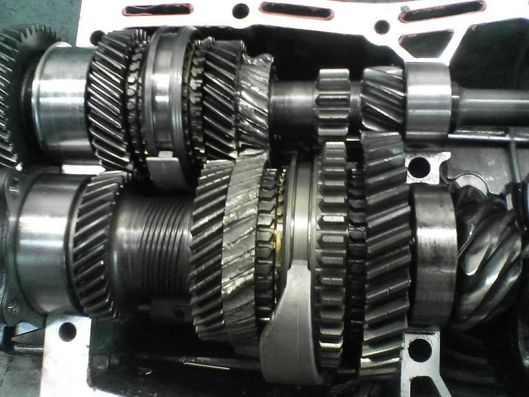

well the guy at Carlsen that tore it down said that the whole tranny is "hammered". but whats wierd is, that every gear was working except 2nd when id disengage the clutch, and now they gotta wait for some field guy to come check if its gonna be covered. im praying for the best so i can get on the road faster and learn from this.

well, the subaru "field rep" took a look at the tranny and said it wont be covered under warranty. there was really nothing i could dispute fmro that point. i even went ahead and called the main subaru manager in the east coast and he said it cannot be covered and it's best to just buy a new tranny from them for $4800.oo. i really have no choice but to go with that.
does anyone know, if i do go ahead and replace my tranny with them, will my transmission still be warrantied or will it not be warrantied anymore? because if its not, im just gonna go ahead and upgrade to something stronger like cyro gears or an sti tranny.

UPDATE:
well, i picked up the car earlier today and i had to pay $4900.oo. Snot Rod was right about the new warranty about the tranny. its 1 year but unlimited milage. I hope everything stays good from here on out. thanx everyone for you input and heres a picture of the tranny.
