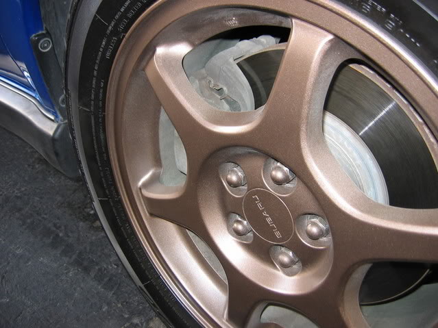

I painted them Bronze --
My technique for DIY painted wheels
Dismount the wheels from the car (you can keep the tires on).
You need to sand the clearcoat off first. I used 800 grit wetsand, then finished it with 1000 grit wetsand. This was overkill...too fine. It took like 1 - 1.5 hours per wheel to sand the clearcoat off. If I were to do it over again, I would use 400 or 600 grit or a red scuff pad, then finish/polish with 800 wetsand
Once all the clear is off and its pretty smooth, wash the wheels with a sponge and hose, then dry them off. For the paint to stick well, you need to get them REALLY clean, so to get rid off any grease/fingerprints use 100% acetone (nail polish remover) to clean the surface. You can find it at RiteAId / Longs for a few bucks.
When they are all dry you can start to paint. I used index cards to block the tire from being painted. Just wedge a bunch of index cards in between the rim and tire. That will block off the tire from overspray, unless you get really crazy with the paint.
I painted them in a garage, with little ventalation, it sucked! Make sure you have good ventalation or a mask for all the fumes. I used Etching primer, Bronze Wheel Paint and Clearcoat (all Duplicolor) I did 2 light coats of etching primer, then waited 30 Min before applying the bronze. I think I did like 5 light coats of bronze (waiting 10-15 minutes between coats), applying in a SLOW horizontal sweeping motion, slightly overlapping and about 5 - 7 inches away from the wheel.
When I felt like all the surface was properly covered in bronze, I waited 1 hour before applying the clearcoat. I did 2-3 coats of clear, but if I were to do it over again I would do 5 - 6 to make it a little shinier. Then wait 24 hours for them to dry.
If you have any painting skills, it should come out nice. Before I did this, I went to a paint store and asked for advice, as I had never painted anything. Im going to re-paint them again better....I didnt use enough clearcoat, so they get dirty with grime and brake dust VERY fast. More clearcoat will solve this issue.
Its been over a year and the only chips/dings have come from having it aligned.
