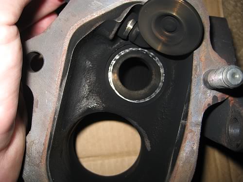

well yesterday i took the car in for a tune.ed is the man.even though we were unable to finish the tune because of fuel issues(low flow from fuel filter....we hope)and a MAJOR boost creep issue which i included pics of the problem,he was able to make my car purr w/740cc and a 20g.this thing spools FAST and we think it has some good potential.
maybe ed can chime in on the pic but from what i see is a friggin joke.SBR should have never let a turbo leave with a hole that small.we would get to 15-16psi and within 1500-200 rpm it would creep to 25+

Wow.... that's a TINY wastegate port!
That would certainly explain the creep
-- Ed
