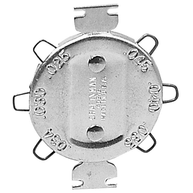

If the gap has opened up beyond factory spec, they can be carefully re-gapped. I would be surprised if that much wear had occurred with platinum (or iridium) spark plugs. Try to find a gapping tool that utilizes a notched blade that works without making contact with the center electrode, rather than those circular gapping/measuring tools that have a hole that is used to open up the gap.

Not sure what gapping tool you are describing. Do you have a pic or link handy that shows the thing?
Try looking for something like this model I found at Sears.com. If the link doesn't work, just search Automotive Tools at Sears.com and several spark plug gap gauges will show in the results. Those notched 'keys' can usually open or close the plug gap by bending the side electrode. Better than tapping on a work bench.
