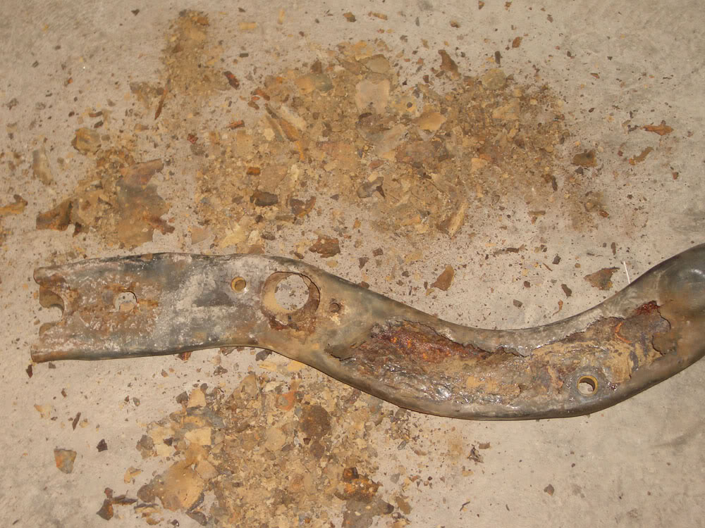

From the factory, mine was draining on the subframe. The subframe was so rusted out that I ended up having to replace it. I believe they started coating the subframe on our cars after mine ('02) but I would still zip tie it to the side or reroute it to be safe...
Here is the stocker:
Up close:
