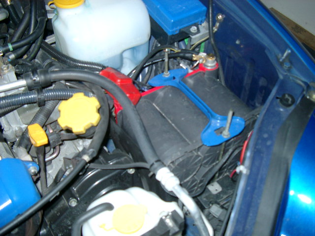

my 02 battery did the same thing, I replaced it with an optima red top from walmart. I got the 35/75 size and 2 battery posts that thread in.
I laid the batery on it's side and the cables fit perfectly.

Hmm - that looks like a decent install - may have to give it a try. Stupid dealer said 'works fine for us'.

fyi
instead of getting a group 35/75 red top, get a 35R red top. It's a direct fit. That's what I put in my wrx. I bought mine at my local Sears Auto.
Second that. By the way, it's just a plain old group 35. 35-910 was the part # when I just got mine.
