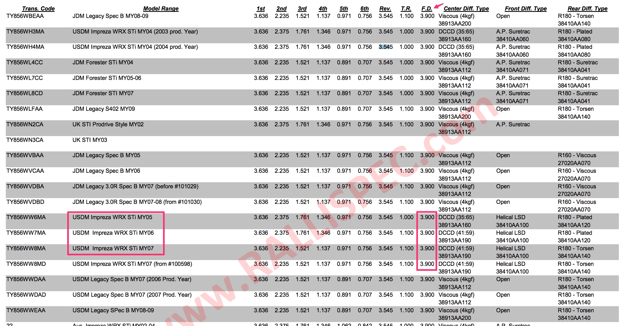

BTW, just because I'm old and probably blind... Where are you guys seeing the Rallipec doc pointing to a 3.54 FD ratio vs. 3.90?
I see a 3.54 reverse transmission gear ratio shown, but not as a final drive.

I never looked at that very closely... It seems that 3.54 FD isn't on the list at all.

Subaru started using a 1.1:1 output on the 6spds so in order for the actual final drive ratio to match the front final drive and the rear final drive are different. Cars with a 3.90 front final drive and the 1.1:1 reduction got a 3.54 rear differential.
That makes sense! I was wondering how they were going to have different front and rear ratios without a constantly slipping center diff...
