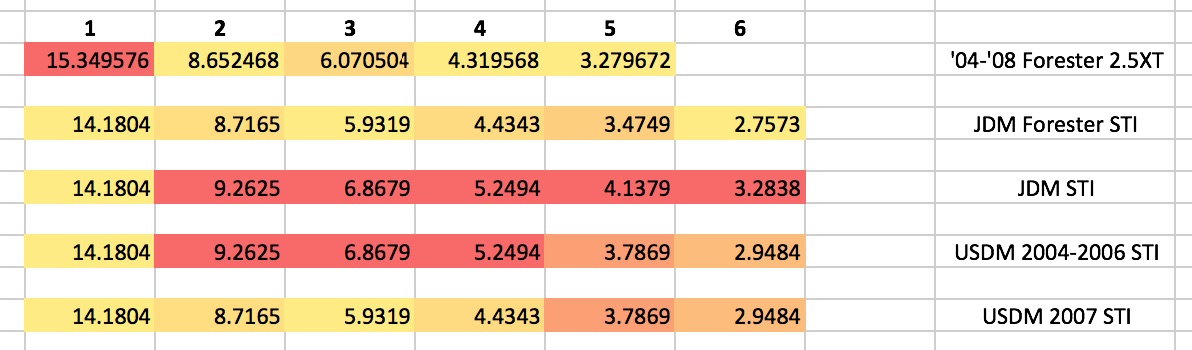

Check out my effective ratio by gear heat map. A 6 speed swap could really change the way things feel. This (probably erroneously) assumed the 2007 STI has a 3.90 final drive.
Red = higher, yellow = lower.
P.S. I made you look at my tranny heat map.

Gear spacing heatmap comparing models. Yellow = farther apart, green = closer together.
P.S. Check out that huge jump from 1st to 2nd in the '04-'08 FXT. Every change is pretty wide compared to the JDM and 2004-2005 STI's (duh, 5 speed). Seems like a JDM STI is the closest-spaced box (also probably "duh" to everyone but me).
P.P.S. I pitted trannys against each other and made them fight for your edification.
