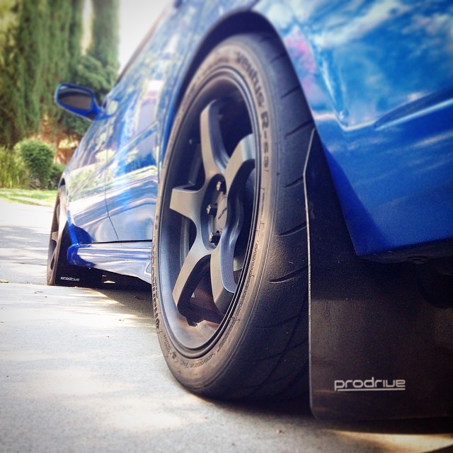

New (to me) tires: Hankook Ventus R-S3s 255/35/18. Oh dear Lord are these sticky. Thanks to Travis for the last minute hook-up.

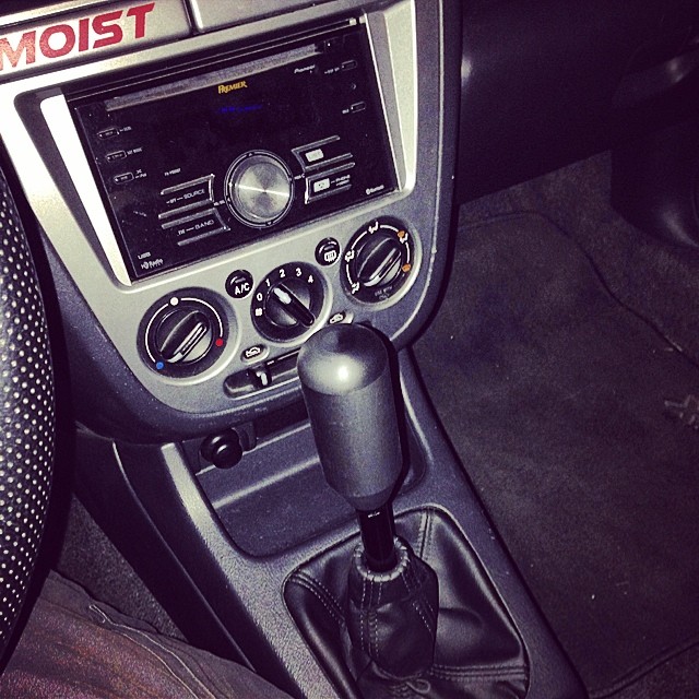

New ****: 4" delrin with a 3" Torque Solutions extensions.
Yes, it's really as big as it looks in the picture.
No, I'm not compensating.
Yes, the throws are a bit longer now, but the height is perfect for me and I like where it sits.

Good gawd, how do you fit those tires on a GD wagon? I'm barely making clearance with 235/40-17 at all four corners

H&R springs + 18x8.5 +44 wheels + -0.5 degrees front camber + -1.5 degrees rear camber + slight roll of the rear fenders = barely ever rub.
Checking out the tire-strut clearance, I could still fit a 265 in there, but then I'd probably rubbing a lot more in the rear.

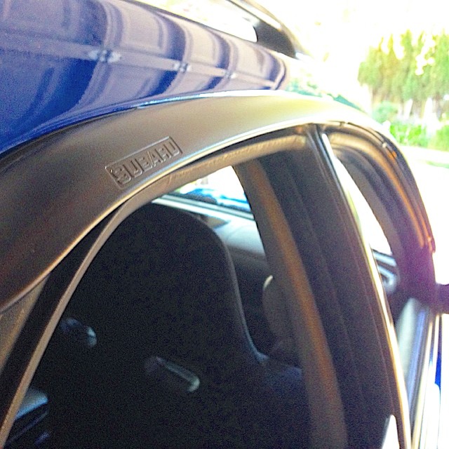

JDM stuffs: window visors

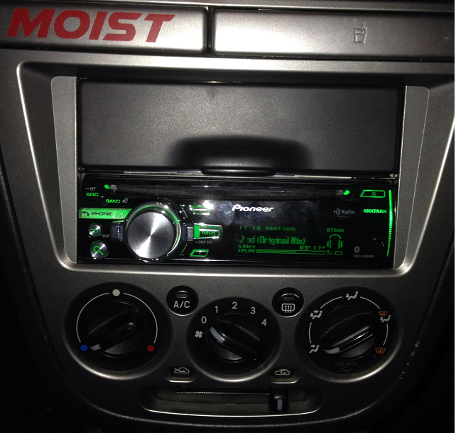

New headunit, Pioneer DEH-X8600BH.
Halle-freaking-lujah for Bluetooth autoconnect. And, as a bonus, sounds amazing!

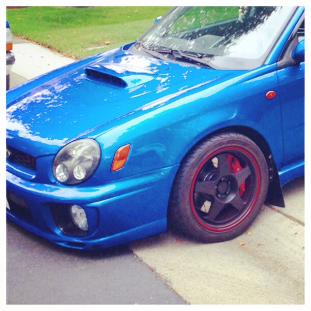

Added painted sideskirts and Prodive mudflaps a while back.
And just recently, JDM oval side markers (props to SUMBARU at Acme Auto Body) and 17x8.5 +48 Rota Slipstreams with 255/40 Yoko S-Drives (thanks to Sybir for feeding the habit) which will be eventually replaced with R-S3s after the winter.
