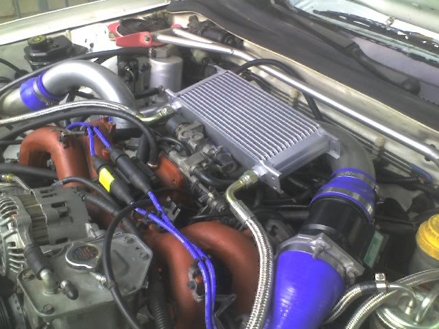

hey, what do you guys feel about this?? if you flame me, i don't care, i'm still doing it. yeeeah!! more in the link.

Originally Posted by 4URABUS
Two problems that I see:
#1) Hot air from oil cooler dumps directly down behind throttle body. With the metal piping it will increase intake air temps, and might cause problems with the throttle body itself (electronics melting, throttle shaft seizing).
#2) Drainback from the oil cooler has the potential to leave it dry when parked overnight. Without some sort of residual pressure valve in the return line and a one-way valve in the feed line, it would cause an air pocket to form in your oiling system. No bueno.
both 1 and 2 your kidding right? ROFL!!!!
BTW..awesome work with the car....been following your journal...just curious when you welded up that crossmember, were you using flux core?

Honestly I don't think you'll have to worry too much about the throttle body or intake temps. The volume of air at speed that a scoop takes in should be more than enough to dissipate the heat from an oil cooler. The top mount may be prone to drain down but its placement after the oil pump negates any issues having to do with pump feed. If anything it might just take a bit for the oil to cycle through the whole system but I'm sure hes already calculated for the extra system volume. Very clean build though, hope to see you out on the road.
