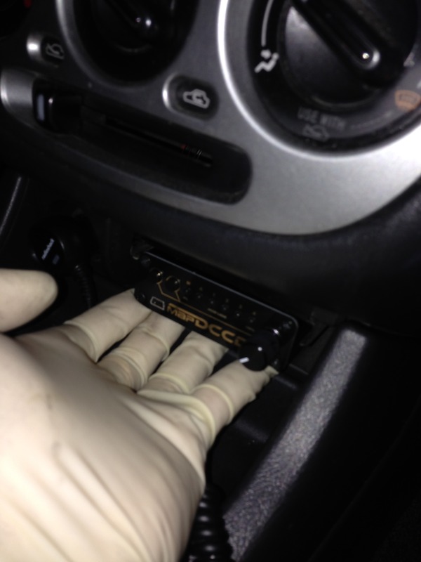

Got the maddccd installed
dccd wire from transmission
I used 3m quick splice with double blade for better connection.
i made a pin diagram for mapdccd . 02-03 wrx.
