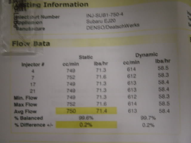

ok I was bored one day and found a deal on a set of jdm aero guards so I ordered it to match up with the front a little bit more, also to get ready for my new turbo setup I needed bigger injectors. I ended up ordering a set of deatschwerks 750cc injectors for my car since if I wanted I could send my stock injectors back to them and get $100 bucks.

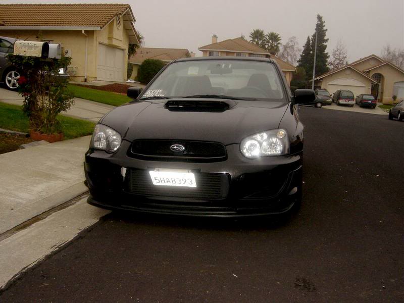

if you look at the pics you will notice that I cleared out the headlights and had it sprayed a dark gunmetal color like the 05's also my wheels I love those wheels and my aero guards. I also bought one of license plate things that angle the front plate. I ordered the one for the jdm plates so I had to custom fit it onto my plate. I tend to be a little lazy when it comes to washing my car so excuse the dirt on the car..hahah I mean this is the family car it's meant to be dirty...haha oh and you will probably notice that I also have the sti hoodscoop on my car. thats because I swap with one of my friends when I was using a tmic. That swap was actually done awhile back ago I just forget to talk about it. I also used the sti air splitter. Not bad but still too small for the hyperflow tmic. I also installed a set of hids for my car f1spec you know the ones that can turn on even under water...hahah weird but true I got the 6000k and those things are bright! Plus the install was super easy. My first few batches I kept getting a bad harness but I kept getting them replaced for free so it was no problem. I've been using them for I think about 6-7 months now with out any problems with the new harness. So I have no complaints with them.

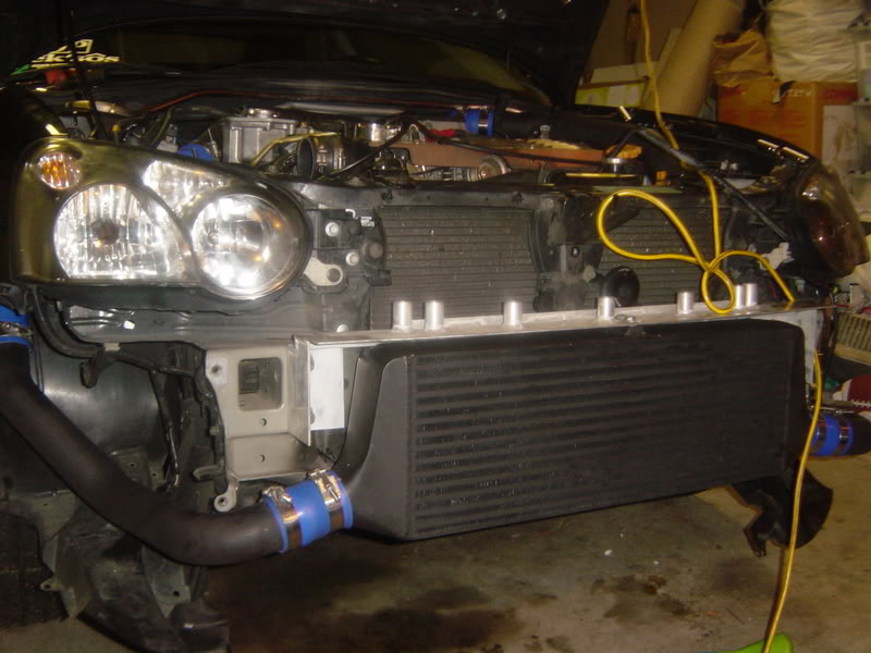

ok well now we are almost at the present time...So putting in the new injectors and fp td05h-20g turbo was not bad at all. But while doing the install a new problem arised...Since I swapped out the turbo out of my car about 4 times the stock turbo inlet hose was all ripped up...That is not good....So I was thinking "hey it should still be fine..." hahah I also put in my turbo xs fmic sprayed all black with high temp paint to give it that stealth look.
The turbo xs fmic is actually not to bad when installing pretty easy. Everything is on top plus it comes with it's on bumper beam so you don't need to cut your own. Here is a note to those looking to go with a fmic, when you first take off your bumper be aware that there are a lot of clips that you will need to take off. It's such a pain the next hard thing about doing a fmic is cutting the bumper. PITA seroiusly man I used a dremel, a saw anything to help me cut it. I want to also take this time to give a special thanks to my friend Alan who really helped me put my new turbo setup together. Without him I would not of been able to finish this project as soon as I did. Also thanks to my friend Sam who also helped out with some of the wrenching as well. here is a pic of the bumper before I cut the black plastic part..I was going to leave it on the car and do some cool design like the dynocomp sti...but wayy to much work then it was worth...
now here is part of my bumper back on my car with the plastic piece on still...
notice how much of that piece blocks the fmic...Man can't block that air flow...

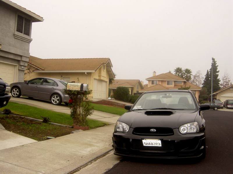

ok so now i've caught up to the present time...here are some pics of the front of my car after christmas..
now i'm just waiting for ed to road tune my car. I also installed a hallman boost control to help my spool up and i'm using a typhoon intake with my fmic donated by my friend to use. Oh yeah I also have a really bad dent on my fender because somone threw a shoe at my fender when this person thought I was spending to much time with my car...ehh oh well I will also be painting my trunk and rear bumper because my wife accidently hit her own car when she was backing out of the garage using my car....So yeah my car still has more work to it coming soon...Well at least body work. I'll show you guys my dent later. It's still hard for me to look at...

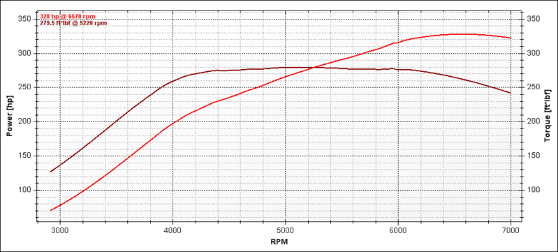

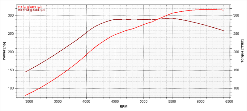

317whp and 292wtq (ending #'s)
328whp and 280wtq (peak hp at 6500rpms)
