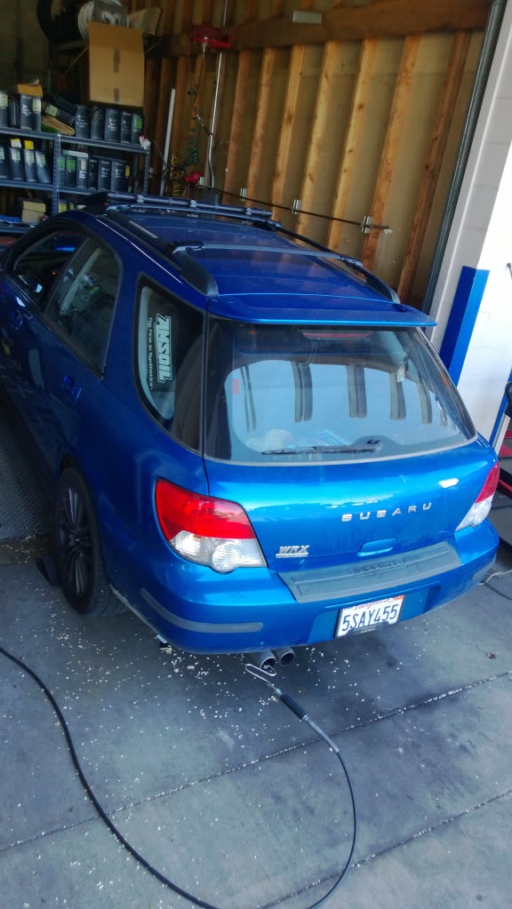

Just got the rear fenders rolled today too.
Big props to Alex (408-807-9812) who I read rave reviews about over on Bimmerforums... no cracking, chipping, stressing ect...
No complaints at all!
