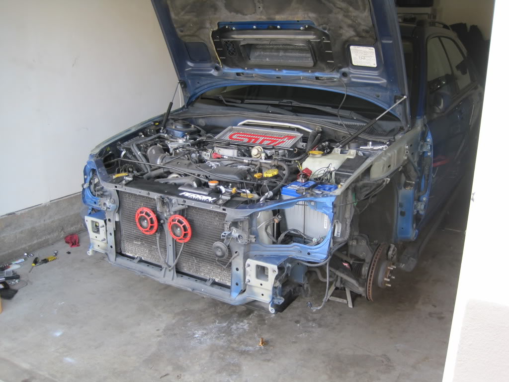

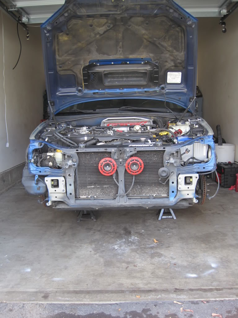

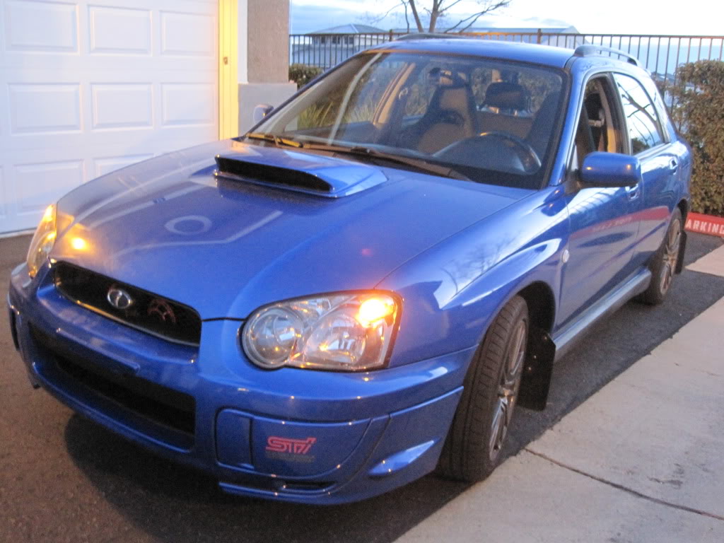

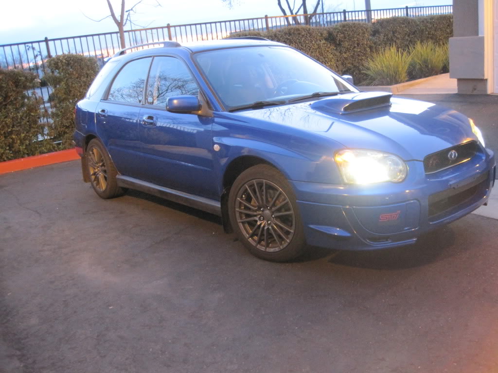

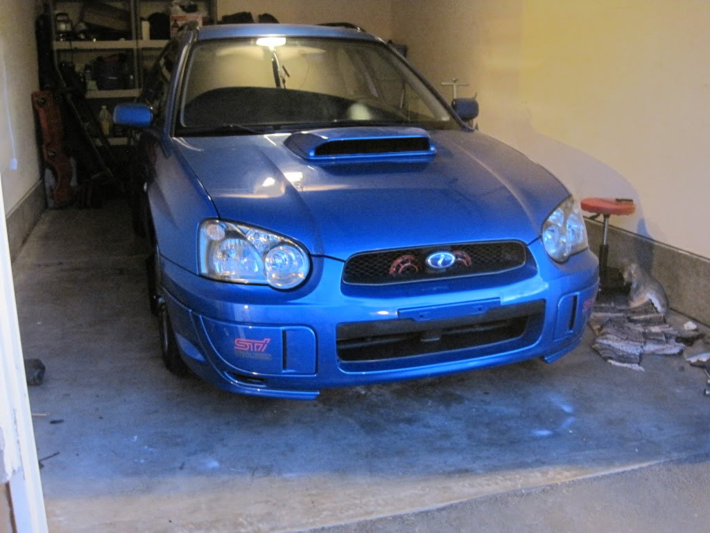

Just finished the widebody swap last night. Turned out really well IMHO. The paint is slightly deeper/darker on the newer parts compared to the front doors back. But I was expecting that and it didnt turn out as bad as I thought it would. There are a few sizable dents on the doors so they are going to be the next things to be replaced...oh no here comes the audio itch!
Here you go!

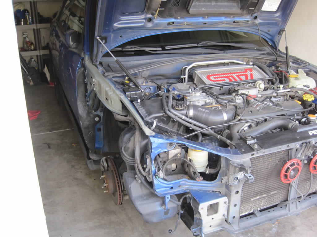

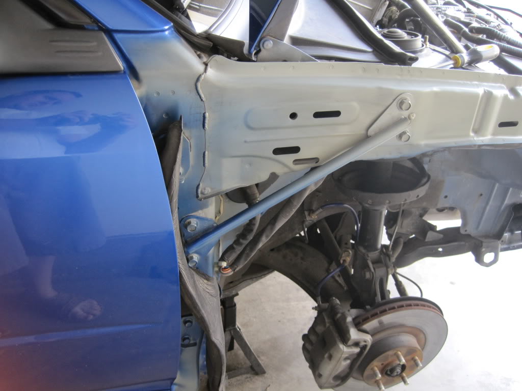

On stands with both fenders/fender liners and bumper removed. Note the overspray on the snorkus. I had suspected that the car had a repaint when I bought it because the end of the muffler can on the back had slight amount of blue paint on it as well as one of the fender liner corners.

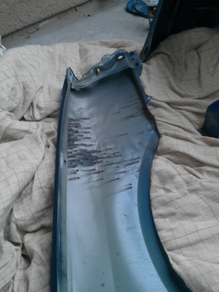

Here is the inside of one of the fenders... BINGO! Did a pretty good job considering I still cant tell when I turn it over.

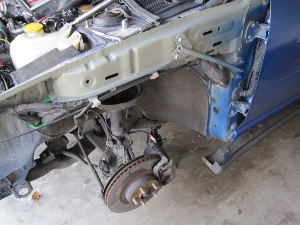

Fender Brace installed:

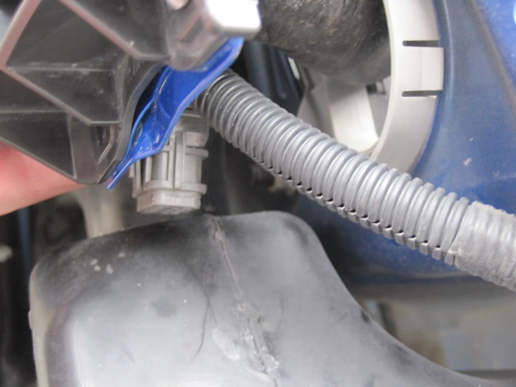

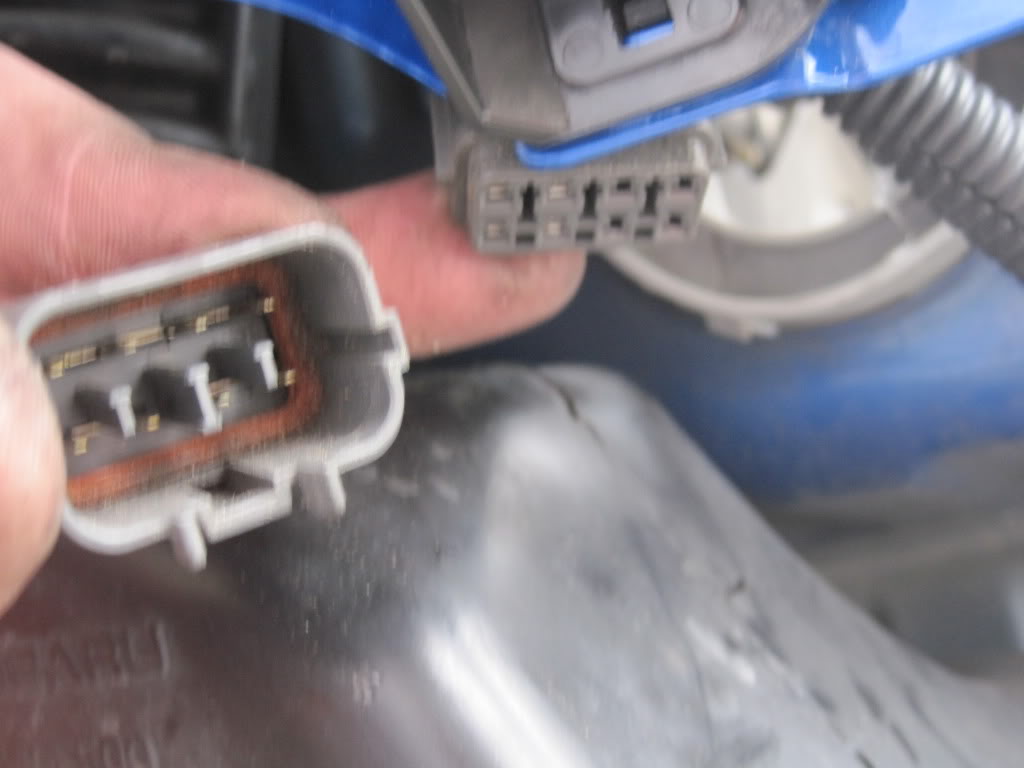

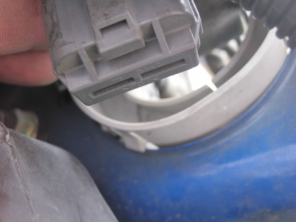

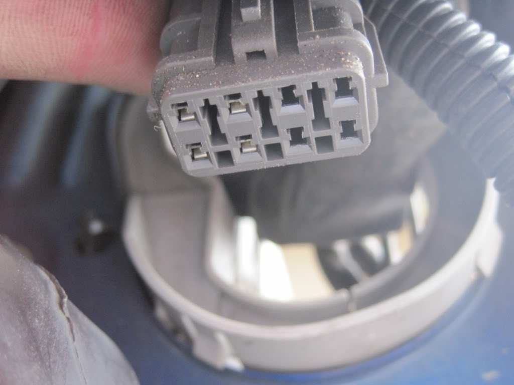

Came across this capped plug right next to the snorkus/ opening for wiring harness to come through the fender into behind the headlight. Anybody know what it is for?
Here are the final results... Sorry but I didnt take too many pictures of cutting the bumper beam for the JDM fogs as it is the same as all the other posts. I will get pics without foglight covers later today.

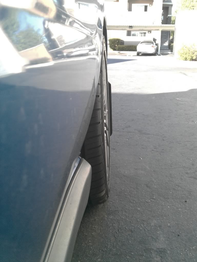

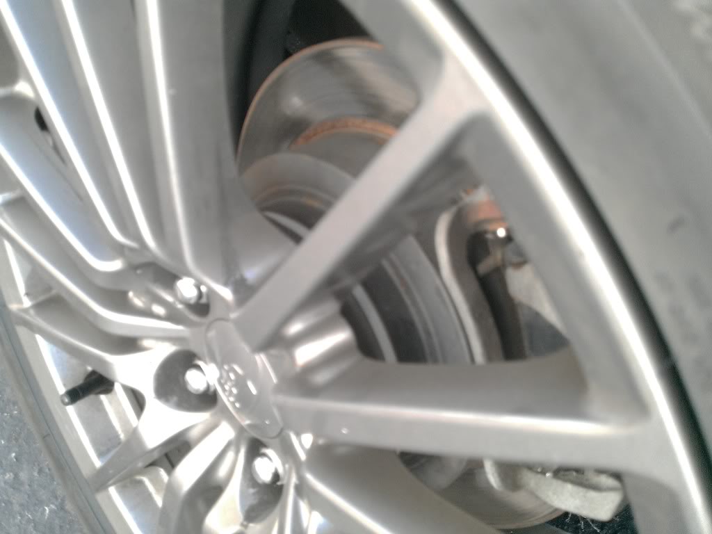

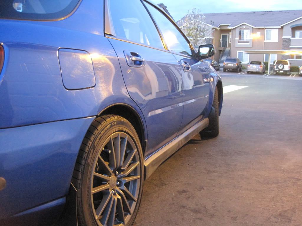

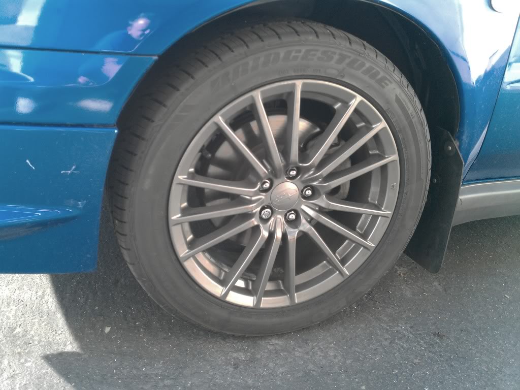

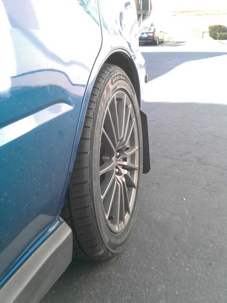

I bought some 245/45/17 RE970 Pole Positions for $350 brand new from a guy in Yuba City who had bought them from tire rack (still had shipping labels along with manu stickers) but then sold his Benz.
Considering my clearance was already next to nothing in the rear, I went ahead and installed 5mm Eibach pro spacers.
Drilling the dust shield was fun... so was dremeling the new studs so they could fit through the ABS sensor hole.
IMAG1012.jpg?t=1334541821
I took them to Firestone of Roseville and they mounted, balanced and installed them. Because they were still brand new with stickers, they were even able to get the 40,000 service warranty in my name too!
Figured I would get the lifetime alignment while I was there because three of the 4 were off. Now I have no reason to not tackle widening the front track!

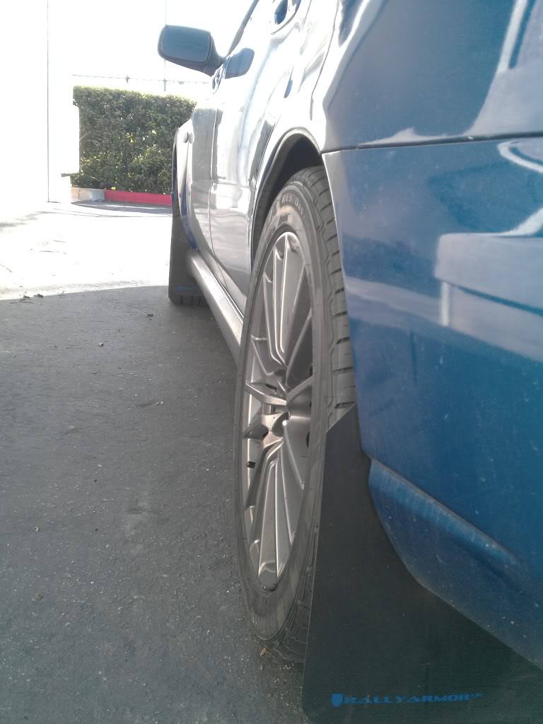

If I hit speedbumps too fast, the rear tire rubs the rubber wheel well moulding... might need to get them rolled here soon.
Anybody know someone in the area who I can go to?
