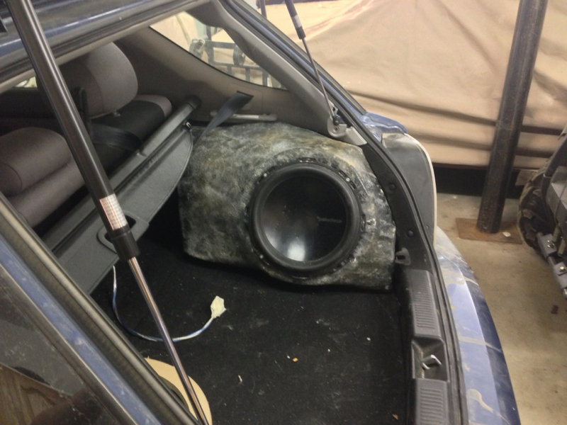

As far as the inside is concerned, I have not gotten very far. I have built a custom fiberglass sub box, that has a Rockford 12" in it. As I type this I am build fiberglass door pods for the rear passenger doors. They will hold Rockford 6.5", to replace those little crappy cheap speakers we get. I also removed all the green from the gauges and I am waiting for the blue LEDs to come in.

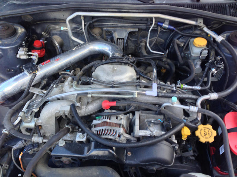

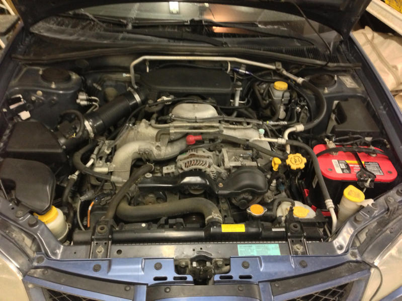

Here some pictures, I will try to find some before and after of the engine bay when the new intake comes in.

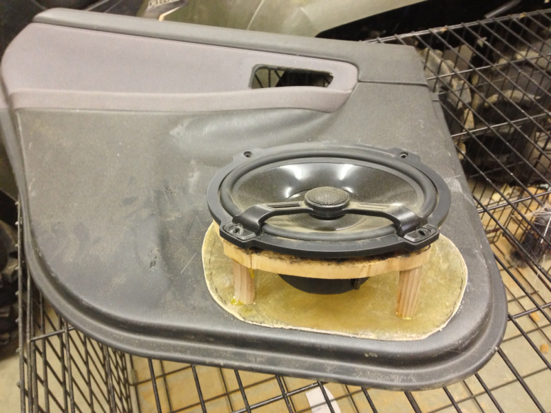

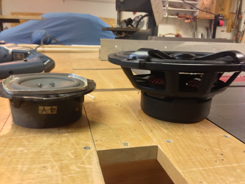

Starting to get a little worried about the door speaker pods. I did not want to cut the door, so they will sit on the door panel.

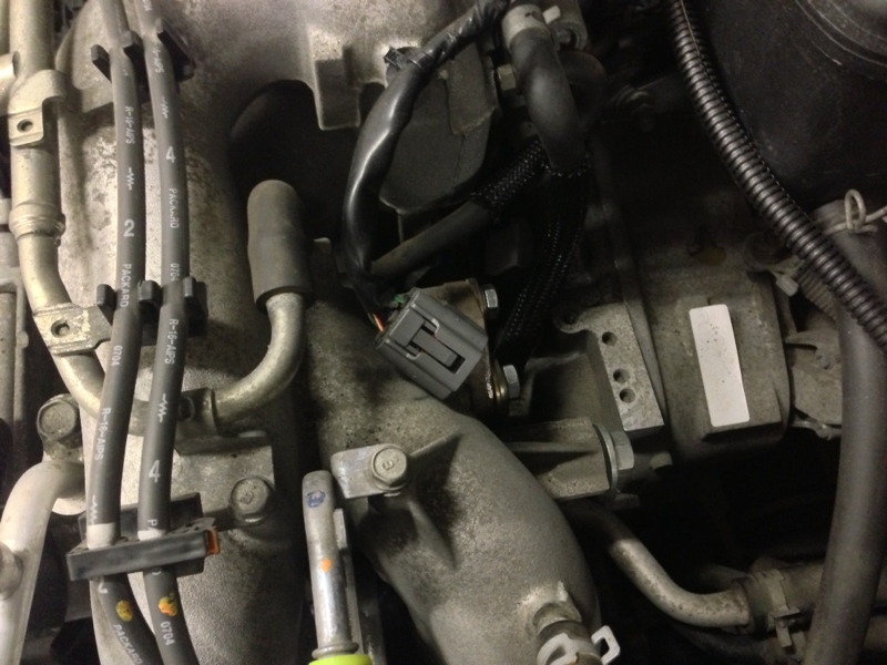

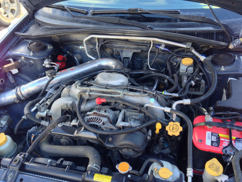

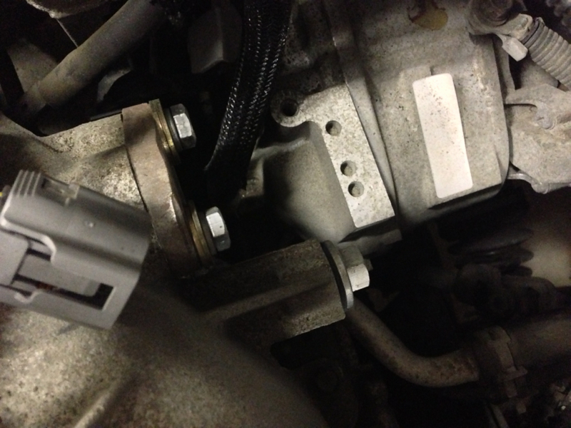

Okay here are a couple before pictures, you can see the plate I made for the egr valve delete. Then I used some 10.5 oil plugs to seal up the egr system. The next set you can see the new injen cai.

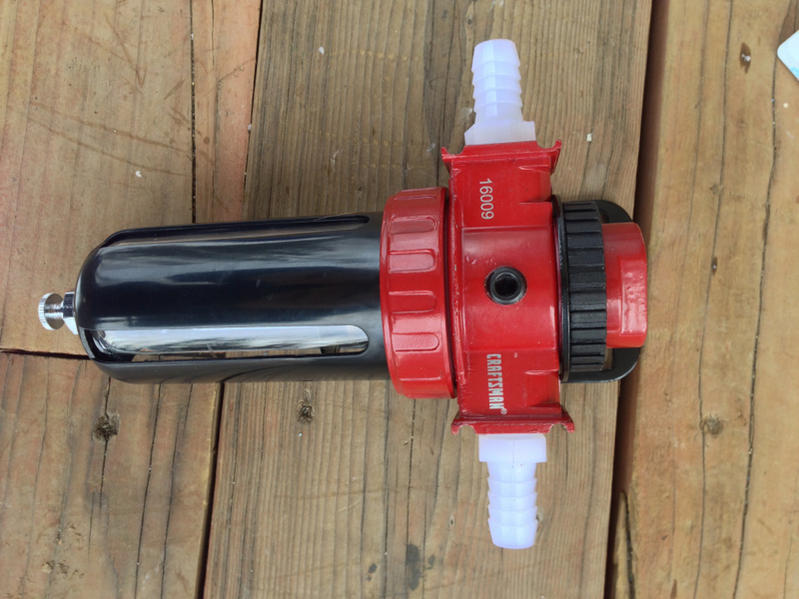

So yesterday I installed the poor mans air/oil seperator. I went to sears and bought an air water separator for an air compressor. I used clear tubing so I could see the stuff in the line.
