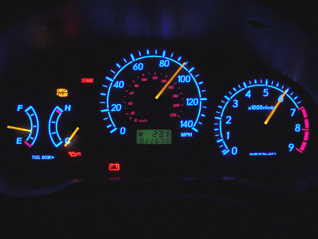

Only thing I could think of is that the area around the needle is not totally flat. Did you double side tape the area around the needle? I had to use some thin 3M double side tape to tape those area so when the needles move, they don't tough the gauge. Good luck.

Originally posted by STIwannabe
Need help! I installed the indiglo gauge cluster and it lights up, but now my speedometer and tachometer do not work. I did not remove the needles, I just move them a little to get the gauge face on. Both the gas and temp gauge work. Any ideas?
-Rob
There are quite a few plugs on the back of the cluster, push it back a little just to ensure that all the plugs have contact. The speedometer and tach plugs may be a little loose.
