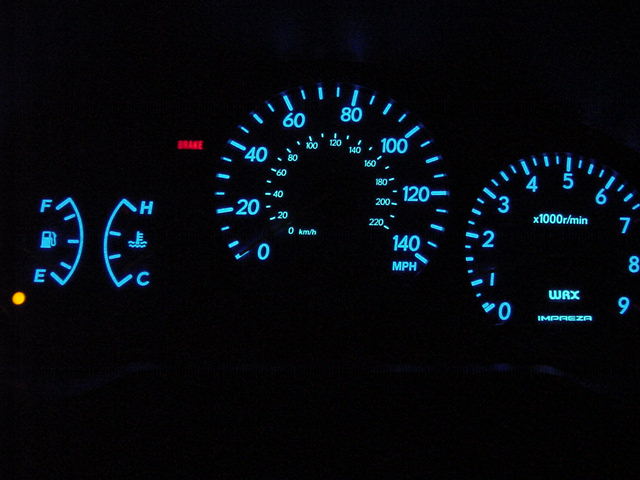

Ok, I need the detail of your indigo.
Is that installed by you or professional?
The needle is operate along, so the indigo won't affect the needle.
Is the needle no light or the indigo block it?
Need detail before I can help you.
If you are in southern cal, I can help you in person.

hmm I have the same ones (or very similar) and my needles show up fine at night...maybe u forgot to plug something back in? like maybe the stock lighting b/c thats what gives the needle the light..

ARE YOU IN SO CAL? Your problem may not be fix if just base on the situation you told us. There may be something wrong.
I need to know where your power +/- connected to? tapped on one of the illumination cable?
You don't need to cut any potion of the guage face since it should perfectly fit on the cluster.
If your needle light not go on, so as the radio light as they are coming from same power source.
Tell me exaxtly how you install the guage.

"Sometimes you have to check the dimmer turn switch on the signal lever which located at left side and behind your steering wheel.
you have to turn to full brightness for the indigo and needle becomes light up. If you accidently turn to no brightness. all light will goes off.

seems like the indigo connect right.
Did you check the dimmer if it turn to full brightness?

try tap the negative to the frame. and try to tap the postive to the illumation wire on your fog light. This is the setting I'm using and working fine on my indigo.
The breaking light stay on all the time? even after you started the engine?
