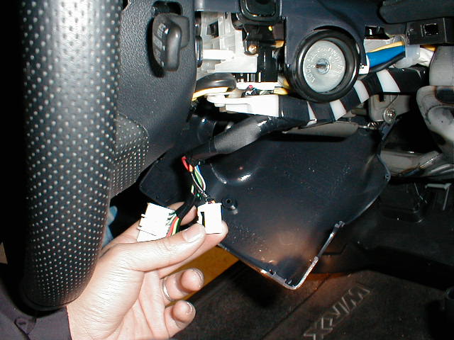

I guess my first problem is that I am not sure which is the parking switch. Is it the smaller one in the pic? The pic was taken from underneath the steering column. If so, then I guess the power is the white/red cable. So I should just cut some plastic off of that cable, solder the red cable from the gauge onto the white/red one, electrical tape it and ground the black one and put everything back together right?

I wouldn't tap the white/red wire as that is probably an ignition wire and u dont want these on constantly.
Get a test light or a multi meter and test it by turning your headlights on and off till you find the correct wire.

K after talkin to a couple of people for you I learned that their should be a source at the cluster itself so check the wires that are going INTO the cluster.

Thanks a ton man, I got it to work! Basically, I followed your instructions, but I tapped the power from the Cruise Control connector. It's the plug that plugs into the Cruise Control button. Wire #5 and mine is purple.
