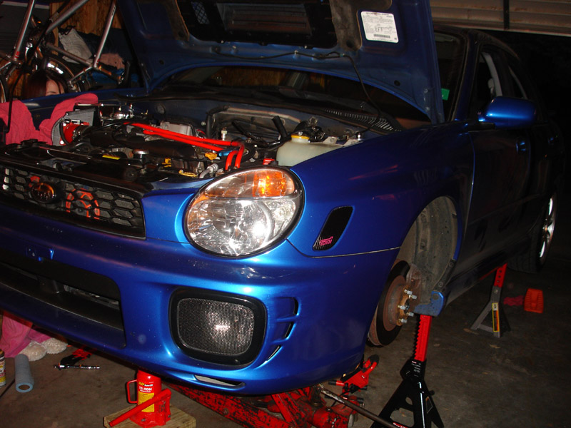

I will try and remember to take some tomorrow. Most of the stuff I've done so far is rudamentary and if you need a play by play for then you shouldnt be doing a tranny swap lol. I got the front wheels off and the car on jackstands. Took off the intercooler, heat shield and exhaust. Im a bit worried as to if the tranny will fit under the car still with it on the transmission jack. the sti tranny is beefy.... need a foot and a half just for the transmission itself, so on the jack you need probably about 24 inches. I'll get it done but this could be a tight squeeze....

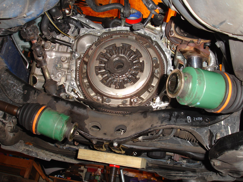

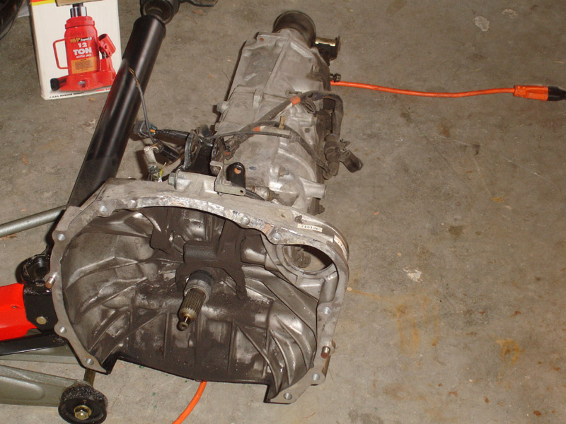

VICTORY IS MINE!!!
Got a fresh start this morning and enlisted my brother and some PB blaster. gave her a quick couple of tugs with a prybar and its out. now for the clutch/flywheel.

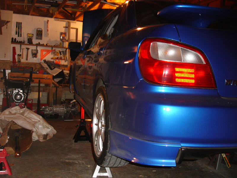

Here's a few pics so far.

oh no! well it would appear that i am hung up again, for something dumb.... I am missing one of the bolts and washers for the clutch cover. the wrx uses 6 and the sti aparently uses 9 and the guy only sent 2 extras. there is also 1 pin missing in the flywheel.... of course its sunday and most places are closed by now. This is really gonna suck if i have to waste a whole day for that one stupid bolt..............
