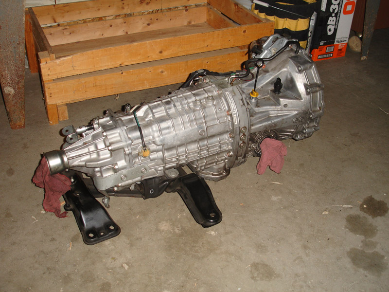

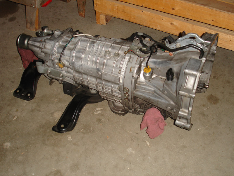

the secret revealed!
uh oh..... look what i found in my garage today? could this be the mystery project?
I think it is

ohhh niiice you doing r180 rear with brakes and all ?? or the auto drive shaft to factory rear end?

its an 07 so its mostly a direct swap. just need the auto driveshaft and stubs for the front axles but i'm actually getting male axles shipped to me so its even easier. gonna go with a new sti clutch and flywheel tho, my stocker has been feelin the pain of 280 to the wheels.

sweet...but the male shafts wont fit your from hubs right? if you dont havd the hubs your better off taking the stub axel out of your 5spd and putting it in your 6

they are newer model male wrx axles, not sti axles (mid 04 and newer wrx axles were switched to a male design) and will bolt right up in place of my existing axles. that way i dont have to mess with putting in stubs and changing seals. I am getting them free as a trade for my axles from the vendor who is supplying my parts
