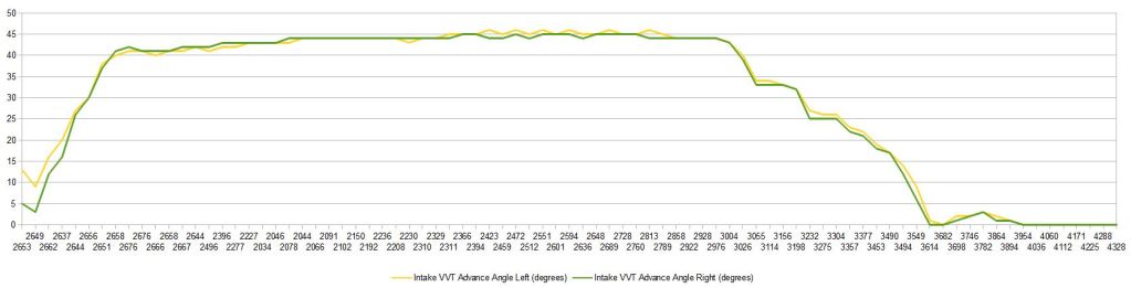

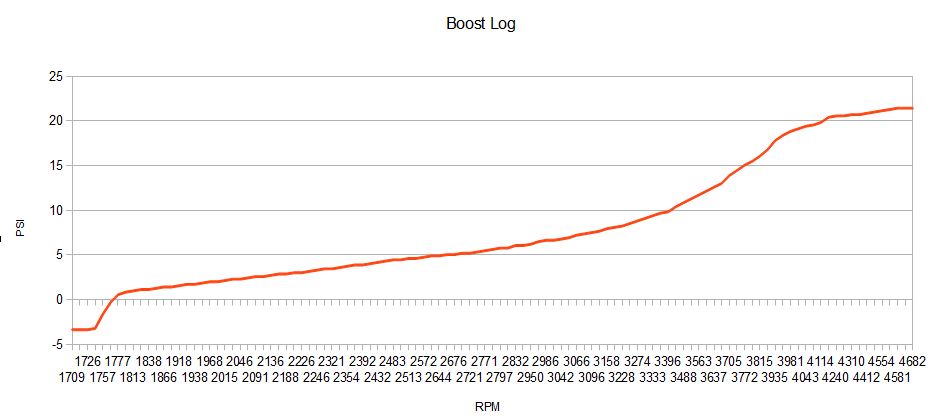

@Krang AVCS is working, yay?
Pulls were done in 4th gear
VVT Angle Graph over RPM
Twinscroll Blouch 2.5XT-R Boost RPM Plot
Old Nov 22, 2011 | 02:07 PM
  #134
ds baruuuuu's Avatar
iTrader: (16)
Posts: 3,206
From: kailua
Car Info: 5.4RS
yeah from that log it looks like the avcs is doing it what is supposed to be doing
