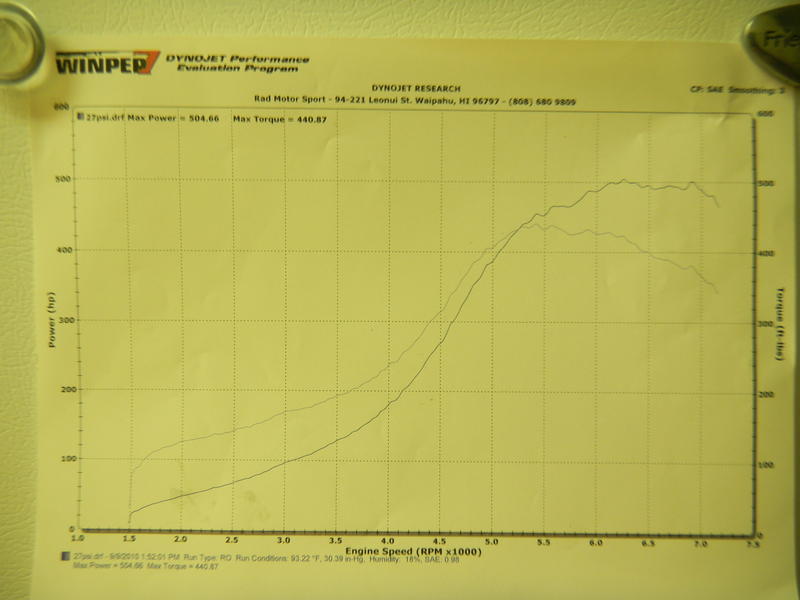

Old Sep 15, 2010 | 03:53 AM
  #111
ricoricanlc's Avatar
Joined: May 2010
Posts: 137
From: Honolulu, HI
Car Info: 2005 STi
Originally Posted by 4080wrx
could you post your dyno sheet and some logs please. I am interested in your curve.
as requested, the dynograph... let me know if you have any questions about it
Old Sep 15, 2010 | 12:34 PM
  #112
reido's Avatar
Joined: Aug 2009
Posts: 243
From: Mililani
Car Info: STI
Nice peak number bro!
Why does your torque come on so late? That's a 2.5k powerband (close to 2k actually)
Did you try runs with an extended redline?
I'm going to guess the AVCS map was zerod out, or still on the standard base table or something and not setup for the larger hotside.
Are you sure that's a 35r? The curve looks like a much much larger turbo.
Old Sep 15, 2010 | 01:01 PM
  #113
reido's Avatar
Joined: Aug 2009
Posts: 243
From: Mililani
Car Info: STI
Wait...what gear was this pull done in? If this was in 3rd gear on STI gearing that looks about right (the curve) and would also explain the high peak number and low end.
Old Sep 15, 2010 | 01:28 PM
  #114
Joined: May 2010
Posts: 137
From: Honolulu, HI
Car Info: 2005 STi
it is a GT 35R and the pull is in third gear. . .
Old Sep 15, 2010 | 01:53 PM
  #115
reido's Avatar
Joined: Aug 2009
Posts: 243
From: Mililani
Car Info: STI
It still looks laggy but less so if it's 3rd gear. I'd suspect the AVCS tables as the culprit, unless the cams have no AVCS.
