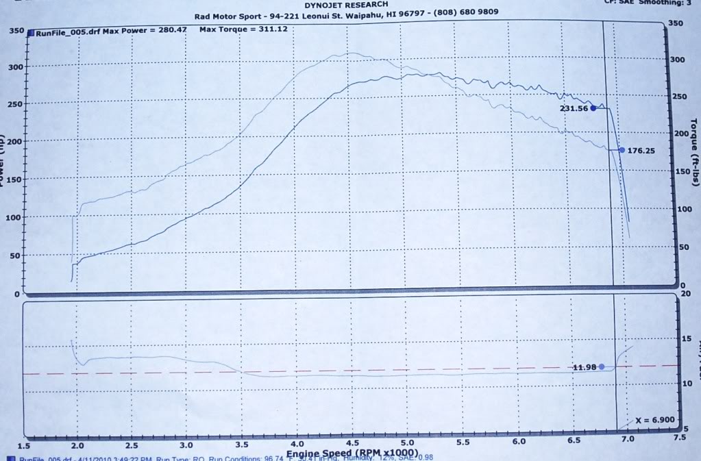

280 hp
311 torque
19 PSI
92 octane
95% injector duty cycle
2007 wrx 2.5 Block
nitrided crankshaft
forged pistons
8.5:1
compression chamber matched 2.0 04 usdm wrx heads. mild port job
arp studs
td05 evoIII 16g
match ported turbine housing
565cc injectors
255 walboro
turbo XS manual boost controller
sti top mount
AEM short intake
OBX header/up pipe
tgv deletes
catless hks down pipe
Blitz nur spec cat back
13lb flywheel
Built by me and tuned by Matt at Benchmark Tuning
