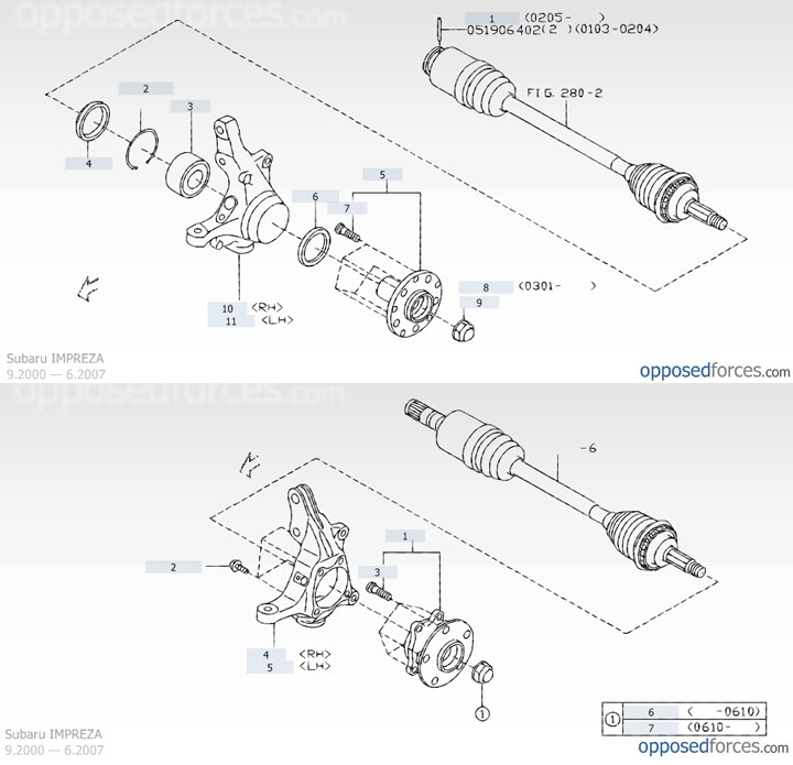

I've had it with the 04 STi Front hub design... broke down and I'm getting modified 05 front knuckles that fit 04 struts. Yay for bigger bearings in 5x100.

They're modded 05 hubs that are still 5x100?
Oh and Jared, your my hero.

Yes the knuckle is modded to fit 04 and prior suspension. The 05 hub is re-drilled for 5x100 bolt pattern.
04 hub on top w/bearing that needs to be pressed into the housing.
05 hub below with a larger bearing in its own cartridge/hub assembly that bolt into the housing.

I'll race Sat but I think I'm gonna sit out AutoX for a while.
At least until I get R-comps and the new knuckles in.
