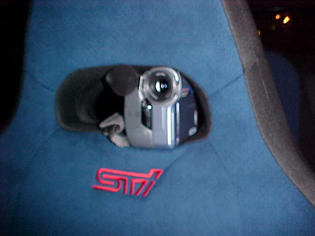

My idea of jamming the video camera in the slot in my seat didn't work that great. Anyone got any ideas?

The way the STi seats headrests are we cant use anything conventional. I built about 8 different models one day and nothing could cinch the mount down enough with all the padding. The WRXs have the nice metal headrests to mount to. I took a nice tripod and just strapped it down in the back between the seats. Worked awesome. Took some real nice in-car video that way and its easy to get in and out.

Let's just say that this didn't work very well.

Cant seem to see the pics on that one, but I remember them and those WONT work on the STi. Check out Dans pic and you can see why. Nothing to mount it to. You cannot tighten anything down enough on all the padding on the headrests to make it sturdy.

I thought your high tech shoestring would actually work. It seemed fairly solid.
San
I know right! Things just don't work out for me.
