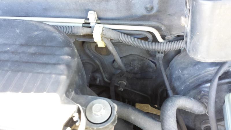

photos 1
Previously, the gas peddle went in perfectly. direct swap. It was the second set that had a slight alignment issue on the top bolts only.
In the second photo, this is where the clutch master will sit. no need to drill since Subaru just placed a rubber plug in the master's spot.
