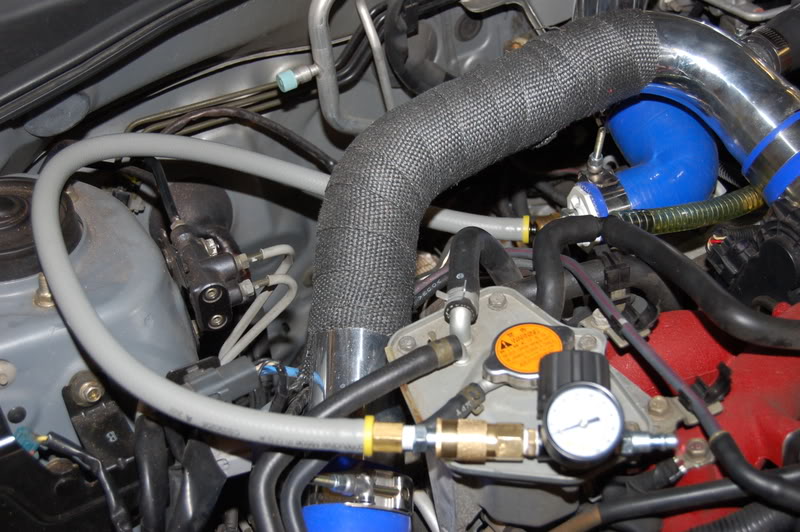

a little elaborate, but my favorite design by far..
http://www.iwsti.com/forums/how-inst...ak-tester.html

Wow..cool,..
Now off to find some PVC pipe caps and put one of my extra schrader valves in one of the caps..
