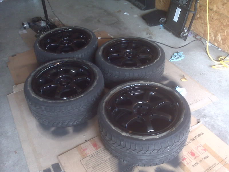

I just did mine.
400 grit is what you want...at least a regular $5 package of that plus a wire brush should get you through scuffing up the old paint enough. I used the paper on all the places it could easily get and the wire brush in the crevices.
Wet sanding is sanding with a fluid like water...this would be more useful after the clearcoat.
Clearcoat is worth is for helping to protect the finish. If you can find the matte clear.
I used Rustoleum because they have a "Performance Wheel" line of spray paint. I got it at Autozone but not sure if that store is in HI.
Prep Completed as far as sanding...hit one with primer already then realized I should shoot all at the same time.
Here's the first one with the primer.
All 4 hit with 1 coat primer, 3 coats Rustoleum Wheel Performance black paint and 2 coats of Rustoleum Wheel Performance clear.
One of them just before I removed the masking.

You're welcome...it took me the whole day mostly because I was sick with a sinus infection and had to take tons of breaks.
All the paint was easy and looked really good. The clear is pretty hard to get even...I guess it is a different texture than regular paint so it doesn't cover the same way.
Old Apr 2, 2010 | 10:32 PM
enzo350's Avatar
Joined: May 2006
Posts: 290
From: Honolulu
Car Info: Loading...
how many cans of primer and paint did you go through?
how did you paint the insides?
Old Apr 3, 2010 | 06:26 AM
bpang1's Avatar
Posts: 7,925
From: Spokane, WA
Car Info: '04 WRX Wagon
One can each. I actually have a bunch of the primer left and maybe 1/6 of the paint can for touch ups.
You do the insides first...turn the wheel over. Then turn it back over for the front. I only primer'd my inside of wheel because I don't care.
