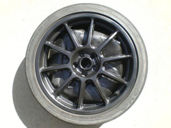

i did my own... ill get some pics for ya if you like
Old Aug 6, 2008 | 01:42 PM
k im bored at work and here are teh pics lol

clean your rim really well and thats about all i did for prep work.. take a deck of cards and place them in the gap so you dont get over-spray on your tires
some paper behind the rim to prevent over-spray onto the ground

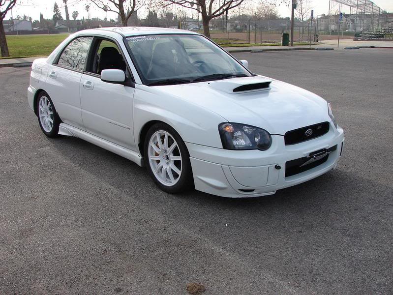

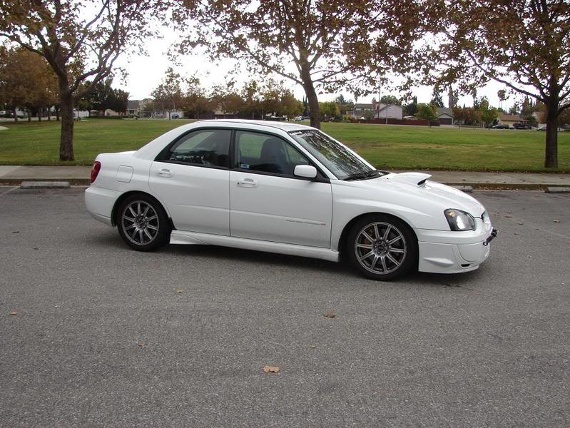

I would recommend powder coating if you have the extra cash laying around, but if you don't do what I did and paint the suckers! about $20 of paint vs. $50-$75 per wheel powdercoating.
most IMPORTANT thing is to prep the wheels for primer,paint and clear. getting lazy on the prep work is why people's who paint there wheels have them chipped. here's the very basic steps to painting the wheels:
1. begin by throughly washing the wheels with dish soap and water. dry them off and begin sanding. I use 400grit to do this. make sure u hit every corner of the wheel. once the wheels are fully sanded, wash them again. this is by far the most important step so dont slack off here, i spread the work out between two days. first day prep/second day paint.
2. get some index cards and place them around the rim if you still have the tires mounted. now your ready to spray the primer. I used rustoleum "stops rust" primer/paint/clearcoat for my wheels. I believe they have this paint in gold also.
3. begin spraying with a very light coat in a covered area so as the wind will not blow dust on the wheels. TIP: dont expect to cover the whole wheel with the first coat, 3 light coats are better than 2 heavy ones. my method was 3 coats primer,3 coats paint, and 3 coats clearcoat waiting 15 minutes between each coat. i painted mine front and back.
4. once the wheels are painted, it's ideal to let them sit overnight to dry but if you need to mount them wait atleast 4-5 hours. now enjoy the new look of your suby. it's been about 8 months since i painted them and I have not had a single wheel with any major chips or cracks. only a few small ones but that was from playing in the dirt sorta long but i hope this helped you out.
here's some before and after pics of my car:

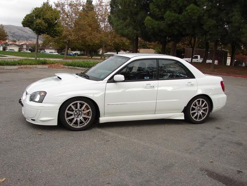

BEFORE

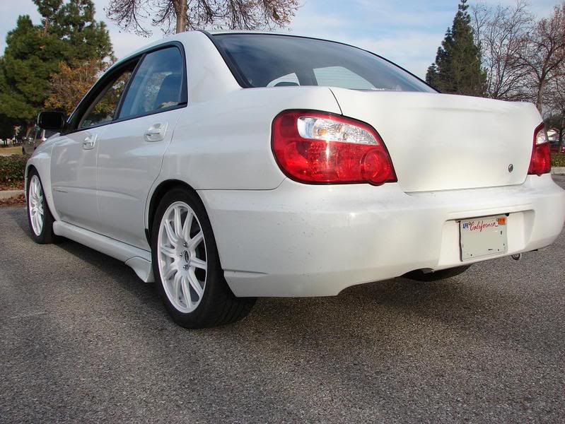

AFTER
