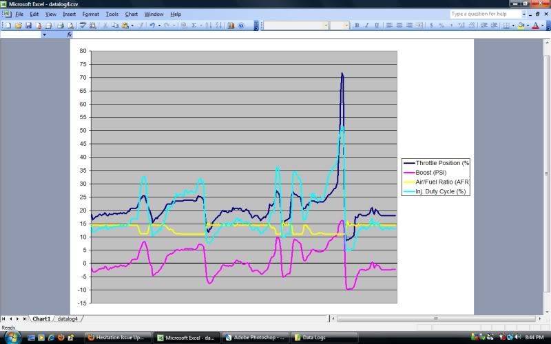

Old Mar 18, 2010 | 08:40 PM
bpatrick's Avatar
Joined: Apr 2007
Posts: 396
Car Info: 2007 Impreza WRX Limited Bugeye Conversion
Full pull 1st, 2nd, 3rd gear...
So what do you guys think?
