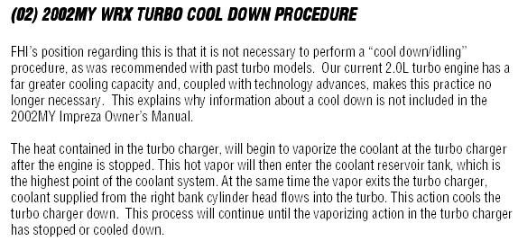

Hey amtrac24 welcome to the club. The turbo timer is not necessary in our cars because the turbo is both oil and water cooled. This means that the water remains flowing through the turbo after the car is shut down due to the convection (heat) of the engine. If it was just oil cooled, then as soon as you shut off the engine, the oil would harden inside of the turbo, which is known as 'coking'. You don't want that, but you also don't have to worry about that, so a turbo timer is NOT neccesary. Save your money, also you can get more information if you do a search. Where in NY are you? Enjoy your car and drive safely

Turbo Cool Down Procedure: https://www.i-club.com/forums/attach...chmentid=26070
