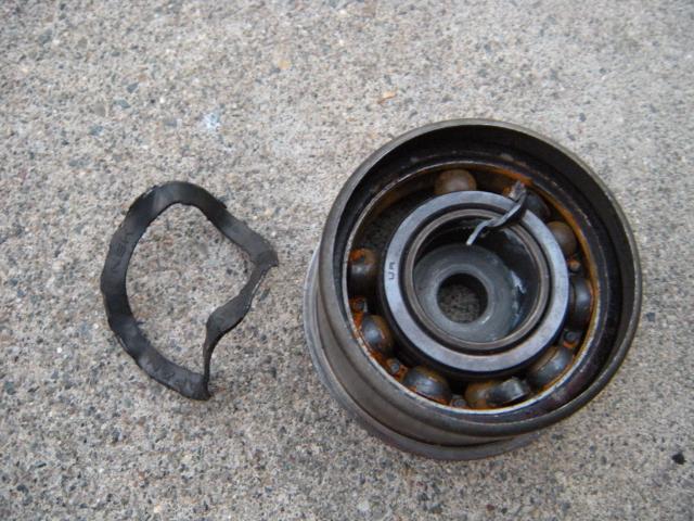

Is it squeaky sound?
Timing belt idler pulley?
Mine failed after 30K miles of installing it.

Not related, but may I ask how your pulley failed after just 30k? Just did timing belt and wanna make sure I didn't fall into the same footsteps

Not really a squeaky sound at first, just a loud humming nosie. That sucks about your timing belt idler pulley, Im looking at doing the same job...hope i do it correct. Yikes, did it damage any other parts?
I don't know. I guess Gates pulley was faulty.
Hell yeah it did, timing belt skipped 4 teeth, it resulted in slightly bending 4 exhaust valves. had to pull the engine out and take it apart.
