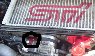

Originally Posted by SubyWrxGuy
Okay, so the "Y" IC hose was not completely flush on my turbo so I put it on better and tightened it down... sure hope that works!
Which elbow are you referring to? The one next to the throttle body, or one of those black ones? Thanks Johnthebrit for the advice
I'm guessing this one. It may have come off underneath. It's hard to see without inspection.

Yup, that was the one! I found the leak. Thank you johnthebrit for the diagnosis!
