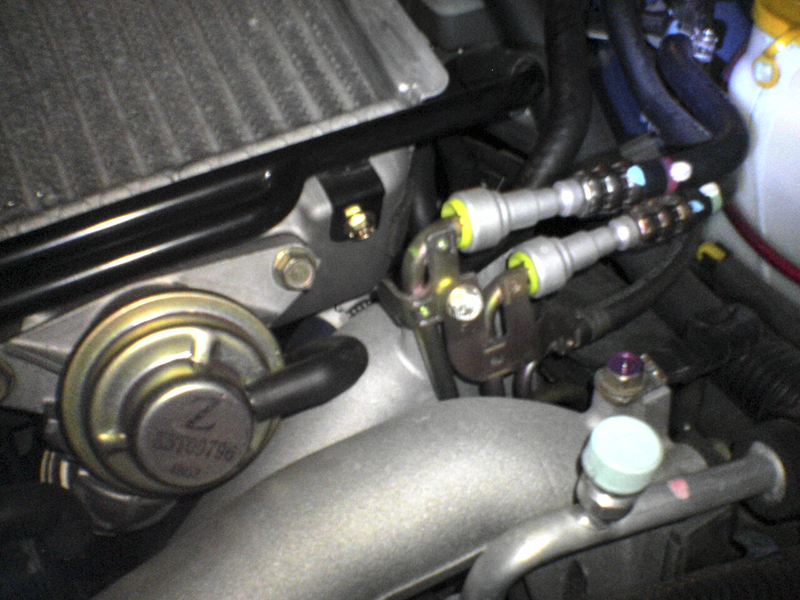

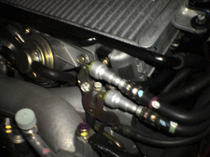

i couldnt find any t fittings. but i did see this which wasnt there before. it seems to go where the vacum hose of the by pass valve go to. you see what i am talking about? those 2 hoses with silver connecters. and then the regular hose below that. and that metal attachment that they are connect to.

Well...those lines with the silver fittings are fuel lines. I'm not sure what those fittings are for...
The boost gauge vacuum line should be tied into the vacuum line coming out of the by pass valve that you took a picture of. The installer must have tied it into another vacuum line some place else.
The line for the boost gauge should be coming out of the firewall right behind the intercooler. Take a look and try to trace it back to where they installed it.

did they add these lines? i dont think i seen them there before?but they all go towards my fire wall right next to the strut. then i am thinking that the bottom hose with out the silve cap is my vacum hose. i dont know.

Those are all fuel lines.
Click on the installation instructions for the boost gauge...
http://www.subaruparts.com/catalog/?section=621
