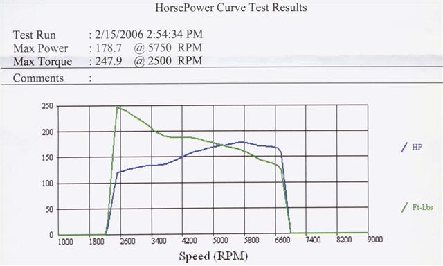

First things first, get to know how to drive your stock wrx, I found a stock '02 wagon to be more than fast enough for everday road use. Puttering around town, I rarely had to go past 3,000rpm to be faster off the line then most people. I think the key is to NOT floor it off the line... you'll just bog like mad and think your car is broken - take some time to figure out the best application of throttle for maximum speed/smoothness. Also, don't be afraid to manually shift gears when you know you're going to need it.
That being said, the 2.0 engine is a little lacking in low end grunt - and the stock Torque Convertor doesn't seem to help matters much.
Things that I've heard help:
1) Catless Uppipe: brings boost on quicker, adds a little power too
2) High Flow Catted exhaust: +hp/tq, might bring boost on quicker (I don't know)
3) Modded Torque Convertor: Supposedly cures poor TC performance (lag/bog), brings the car to power more quickly. Riftswrx said he managed to decrease his 60' times by 1 sec. and increase his highway mpg to 35mpg @ 70mph (Check out www.projectwrx.com for more info)
4) Engine management: Reflash/Protune
5) EJ257 Swap: Swap out your shortblock for a 2.5L one, add in any of the above - costly, but a definate improvement.
P.S. An ATF cooler + Synth ATF is always good for added transmission protection
