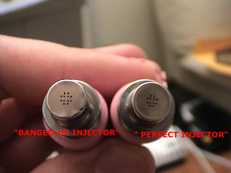

I bought some used STI injectors on eBay. One of the injectors looks a bit "banged-up" from installation/removal and handling. I am wondering if the damage is superficial or if it is going to cause any performance problems. Please see attached image of the actual injectors.
Your expertise and opinion are greatly appreciated!

As long as the holes are not tweaked you should be ok might want to send them to RC engineering to have the injector flow tested and then see if the seller will flip the bill...
Good luck.
Areg

check the o-rings too, ideally change it to new one.

Thanks for advice! How do I contact RC Engineering?

http://www.rceng.com/
