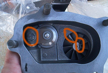

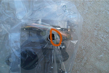

Damaged VF30???

The oil line is just a drain.......put it on the car, no big deal IMO

Don't take any chances, send it back for another.

Re: Re: Damaged VF30???
Originally posted by Turboxs_Nathan
1. The weld spot on the waste gate flapper is normal
2. The bolt on the back of the turbine is also normal since that's one of the ways IHI balances its turbochargers.
3. If the fin on the turbine is painted a little (white or something) then that is the mark used to balance the turbo and is also totally normal.
Exactly as stated above
No worries there, my VF30 appeared the same way(besides the bend in the line, not much to worry about there either though)
L8R,
King

go have a turbo shop check it out.
