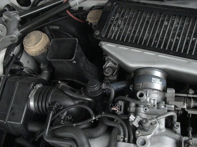

How much boost can this thing safely handle? The engine number is EJ20GDW4PJ. I am guessing that the turbo is not stock. I can't tell what brand the turbo is.
That's a tough question to answer even if we do know which turbo you have because we have no way of knowing how the car was tuned (both boost and ignition advance maps). What are you using for engine management?
Does the previous owner have any records or information he can share with you?

Sounds like you might have some pretty nice mods already done. Don't let the dealer touch your car!!!! Find someone local, and have them check it out!

ej20g is the closed deck if i remember
the turbo if it is stock is a vf 22 or vf23 and the intercooler is i think the largest put in any sti so yes the motor should be fine
it sounds like the dealer knows that you have limited knowledge of your car and wants to take advanage of you for it
the power the car is making now is most likely more than 300 if the boost was increased
as far as gearing if you have a RA sti the gears will be very low and even regular sti's have lower than normals gears compared to other cars
Yep the EJ20G between 94-98 are closed deck, It is more than likely running the vf23 and can more than handle 19psi as long as it's not been thrashed for all of it's previous life.

are you sure about the 94 to 98 because i thought that they where made from 93 to 96 and then semi closed after that
Nope not too sure other than the 98 EJ20G I have in peices here at the shop.

Make sure to put the highest octane gas in it you can get!!!!
Don't let the dealer **** wit it.
Find someone you can trust who knows cars and go over it and make sure all the 'wear items'(brakes and such) are good to go.
Change the oil and filter.....gas it up, and go play

if i were u.. i would run 17-18 psi with that car because you dont want anything bad 2 happen...and make sure u put the highest octane gas into it
