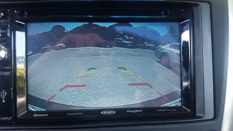

Installed a new stereo and back up camera. Not sure why my images always get turned when I upload them on here.

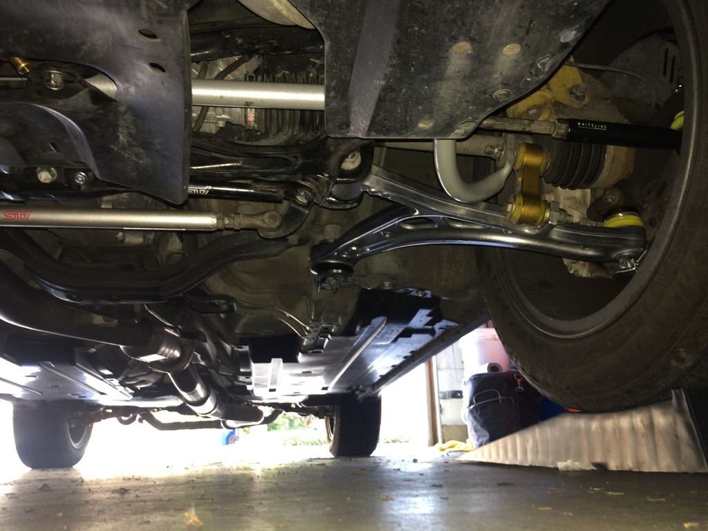

I got my polished and clear powdercoated SpecB front control arms along with Whiteline front bushings (W0508), caster adjustable rear bushings (KCA334) and roll center kit (KCA313) installed today. I also got a Cusco steering rack brace (692026ALHD) with the Whiteline steering rack bushings (KSR207). Alignment first thing tomorrow morning.

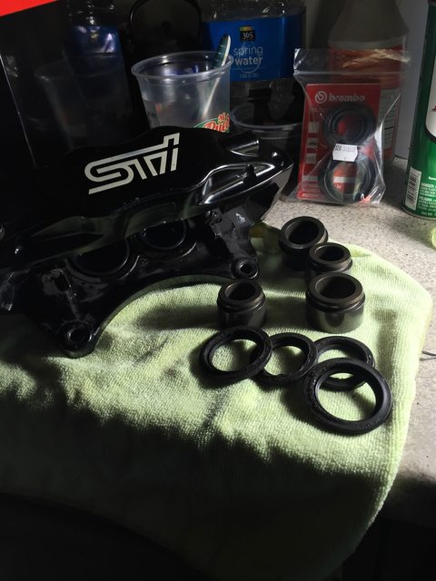

Rebuilt all 4 calipers this weekend. Dust caps were fried after the last track day. Note to self: clean all ceramic brake grease of street pads when switching to track pads.
Had a few stuck pistons at the end that needed to be actuated/lubed a few times so that I could build brake pressure. Was a bit laborious and had to flush/rebleed several times basically wasting RBF600 and ending up using Lucas DOT3 just so I could get home.
Ordering a Motive Power Bleeder and already have RT700 on the way to replace the generic fluid.
