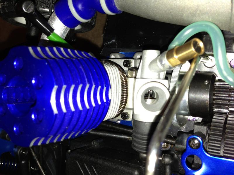

Ok so now I've figured out I need to adjust my idle hers two pics to help you with my confusion the first pic is off the carb with no throttle the next picnics off full throttle which way am I suppost to adjust

in that pix you are about 3/4 WOT.
that black rubber bellows is the arm to the carb. push it closed so looking down the air filter hole, you could see that the carb is closed.
you should be able to turn on the radio and the receiver so you could open and close the carb without the engine running...

so when i start the car it should be pushed all the way closed?

Here's what it looks like with the trigger pulled all the way it doesn't run off any more but it sounds like its revig way to high

that should just idle when you first start the car.
you can then "blip" it to see it wont die.
i used to keep the glow plug igniter from 30 seconds to a minute after it starts.
go watch a few more youtube vids to get a gauge of what idle speed is versus WOt...
now you know why i bailed on nitros. i went and converted a 10 year old revo that i could not keep constantly running, to electric. i am so happy with my e-revo...

yeah now my new issue is that once i took the glow starter off it still revved high but when i tried giving it gas it seemed to sound normal but then the car cut off

see if you can just idle the car on a stand.
i used to remember breaking in the engine by just letting it idle the first tank.
