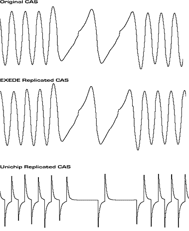

In an effort to clear up a few misconceptions, here's some info on the XEDE:
The XEDE is a interceptor based engine control system (read: piggyback) that intercepts and regenerates the MAF signal (for fuel) and CAS/Crank Angle Sensor signal (for ignition timing). The MAF signal (simple 0-5 voltage) can be attenuated or augmented (for more or less fuel delivery). The CAS (not so simple +/- pulse voltage generated by an asymetric crank-mounted toothed wheel read by a magnetic pick-up) can be phase delayed as well as advanced (using some pretty trick predictive logic) for more or less spark advance. One of the neat things about the XEDE is that it, AFAIK, is the only truly transparent piggy-back system that doesn't interfer with any of the factory diagnostic systems. It is also the only, AFAIK of course, system that offers greater mapping resolution than the stock ECU.
In addition to intercepting MAF and CAS, the XEDE also intercepts and replicates TPS (throttle position signal), Boost signal (PWM % cycle) and MAP signal. More importantly, all the tweakable variables (MAF, MAP, CAS, BOOST and TPS) can be mapped with respect to user-definable load variables (you can chose between MAP, TPS, MAF) and user-definable RPM breakpoints (put 'em... up to 20 of them... wherever you need them).
The XEDE was initially designed for the WRX which, arguably, has the fussiest ECU to keep happy. As a result, much time has been put into retain EVERY SINGLE one of its unique features, right down to it's closed loop boost control. Every single advantage provided by the Subaru ECU (adaptability, knock control, etc,.) is retained. This is why the XEDE has proven to work so well with either stock or reprogrammed ECUs.
If anyone has any specific questions, fire away... I'll be happy to answer as well as I can.

Hi Bill,
I'm not quite sure what you mean about fixing hesitations with simple resets. There should be no hesitations with the XEDE. At least no more than there are with a properly tuned factory ECU (stock or reflashed). When I tune XEDEs, the only time resetting comes into play is before tuning to erase whatever long term knock learning the car has done prior to coming to me. After this, I do what I do with our reflashes... I induce an IAM of 16 and start tuning. The rest of the tuning process is essentially identical to tuning through reflashing the ECU. I still watch and log knock corrections. The only difference is that I do it through delta dash, instead of flash2002 (although I have been known to log with it for its pretty color coordinated tables). The only reason to ever do an ECU reset is if the spark timing or fuel tables were mis-mapped too aggressively. The hesitiations, 5 out of 10 times, is the AIM dropping in leaps and bounds through the course of hard driving. 3 out of 10 times, the hesitation is caused by not having a good handle on short term fuel corrections (ie, transitioning between two load points with a -25% on one side and a +25% on the other). 2 out of 10 times, a hesitation is caused by running too much boost when the car is still in closed loop fuel control conditions. This is easily solved with the XEDE (at least in MY2002-2003 applications) by accelerating TSP input using the XEDE's 3d TPS table. Needless to say, any of these hesitation situations are mapping related and not inherent in the tuning system/hardware.
As for predictive ignition logic, I can't go too much into it for obvioius reasons but the XEDE has always had it. The function of the logic is to always know (or have a very good idea of) where the crankshaft position is at any given time. With the Suby, it's quite easy considering how many teeth it has on its trigger wheel. With the EVO, however, things got difficult since there are only 4 teeth to read off of. It's really quite funny seeing the factory computer trying to do all its ignition duties and misfire detection diagnostics with so little info. The Chiptorque boys and I spent the last 2 weeks on our dyno refining the XEDE's predicitive logic based upon what we saw with the factory EVO ECU. It's really quite impressive. That's about all I can say without giving away too much info

The Xede sounds like a very nice, robust, piggy back with very nice tuning software. I have to ask, however, how is the basic idea any different than the unichip? The unichip may be a bit simpler and the software isn't as user friendly, but its still the same basic piggy back. So what makes the Xede so much better and why don't the problems that applied with the unichip apply here? I know the Xede fixes the PTFB issue the early unichips had, so I'm mainly talking about the ECU learning around the piggy back tuning. Unichip users had to reset their ECU's fairly regularly to keep the tune from going to crap. What about the Xede fixes that?
Thanks
