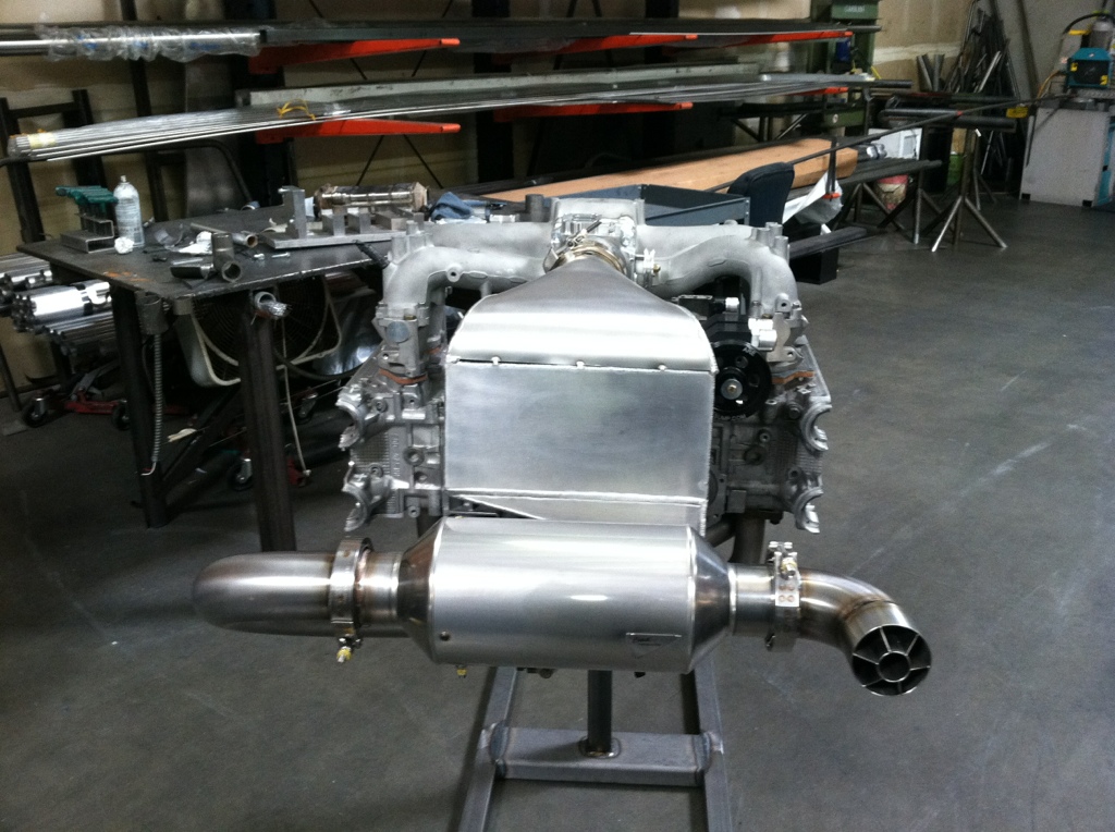

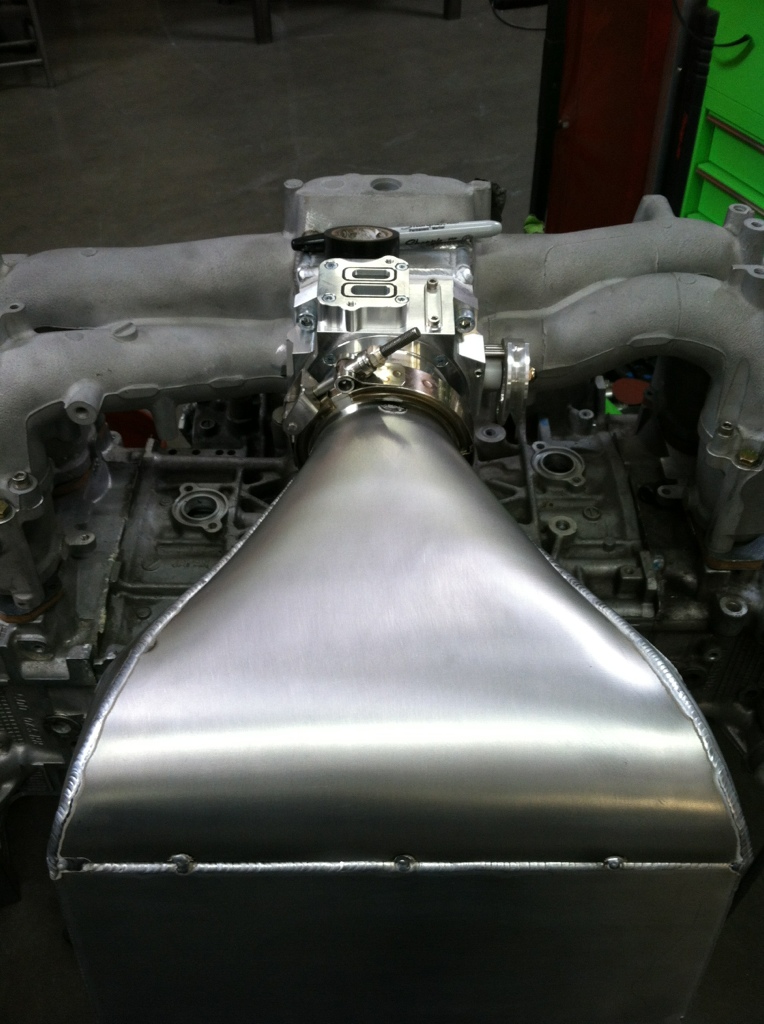

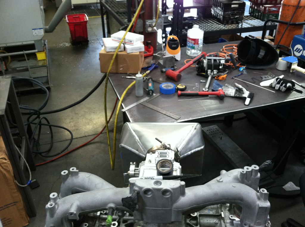

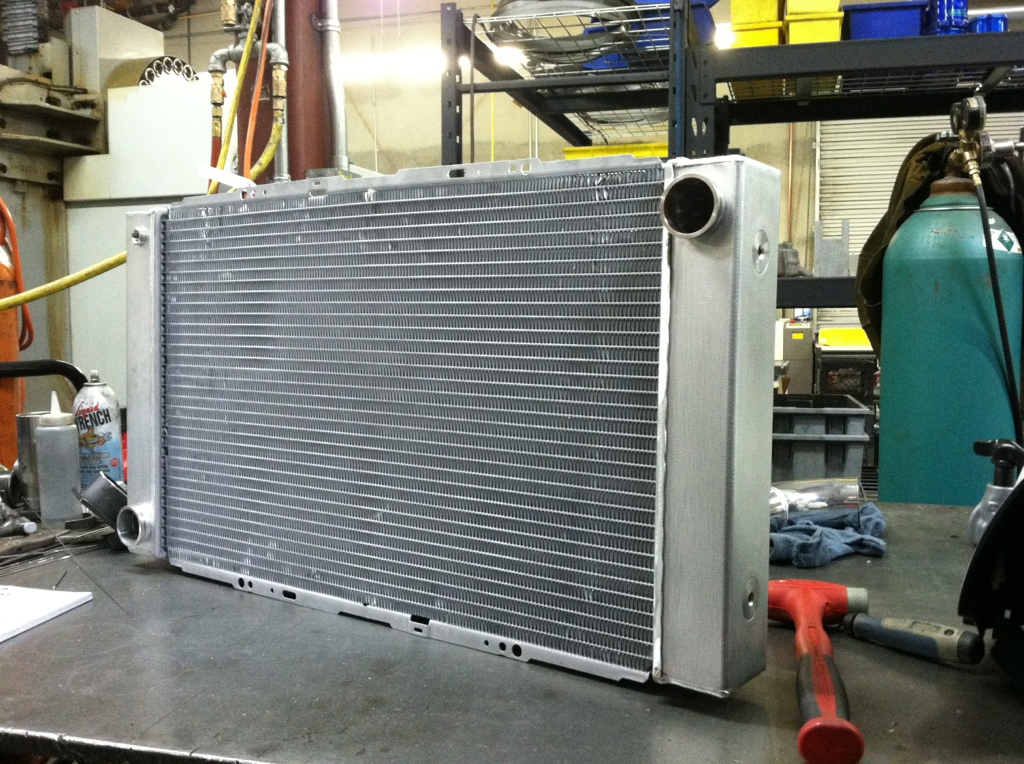

V-mount radiator build

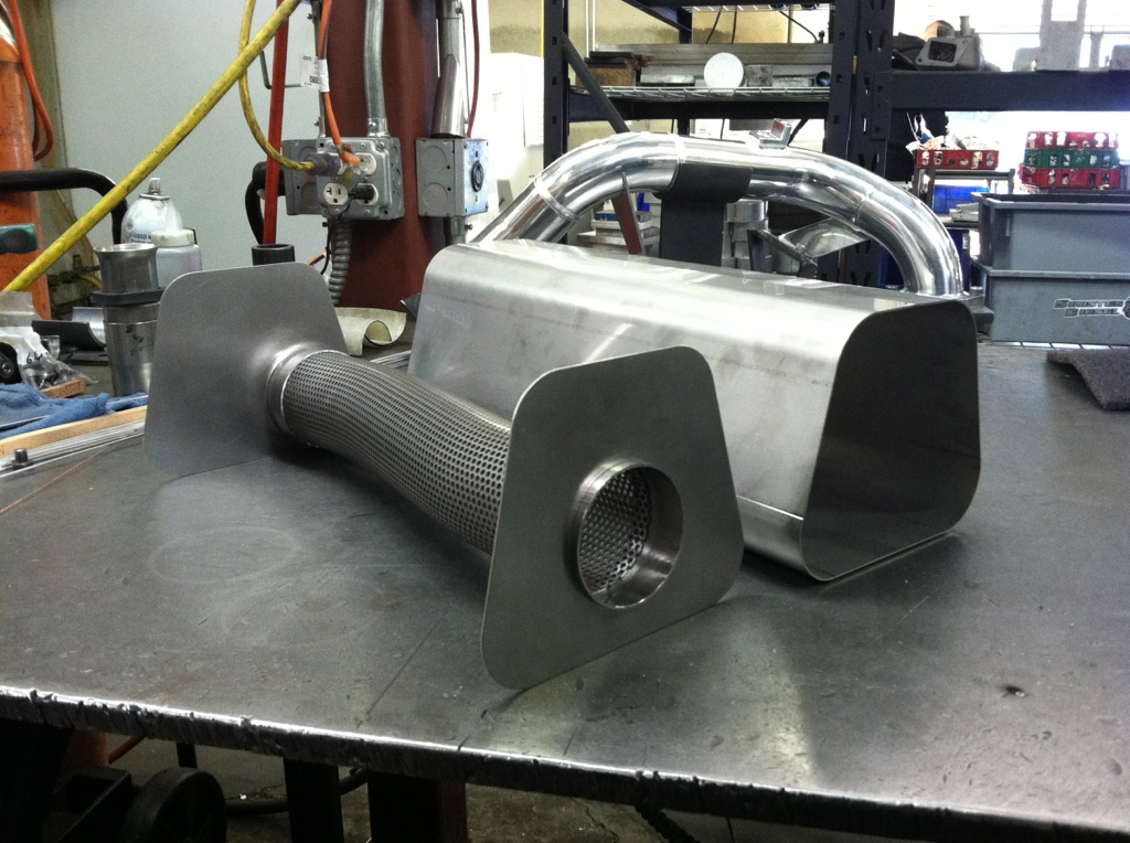

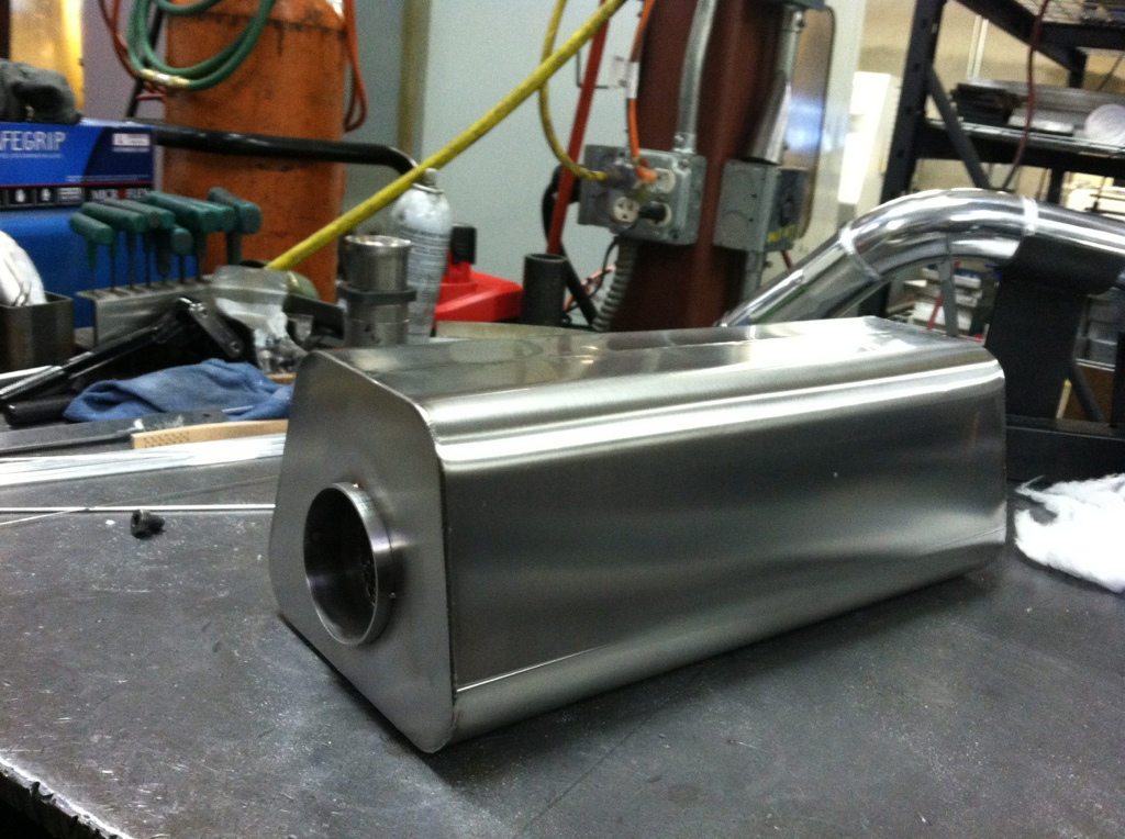

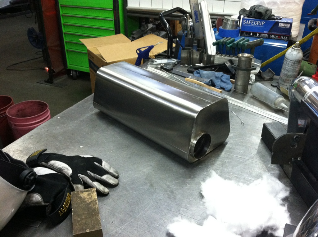

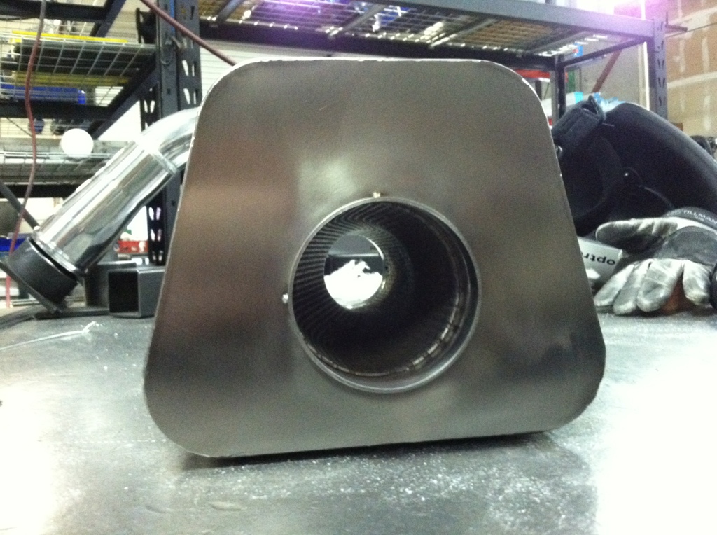

Here is my custom muffler I made. Mimics the oem sti muffler shape with a 3" mandrel bent perforated core. All stainless with a brushed satin finish, and ceramic packing.

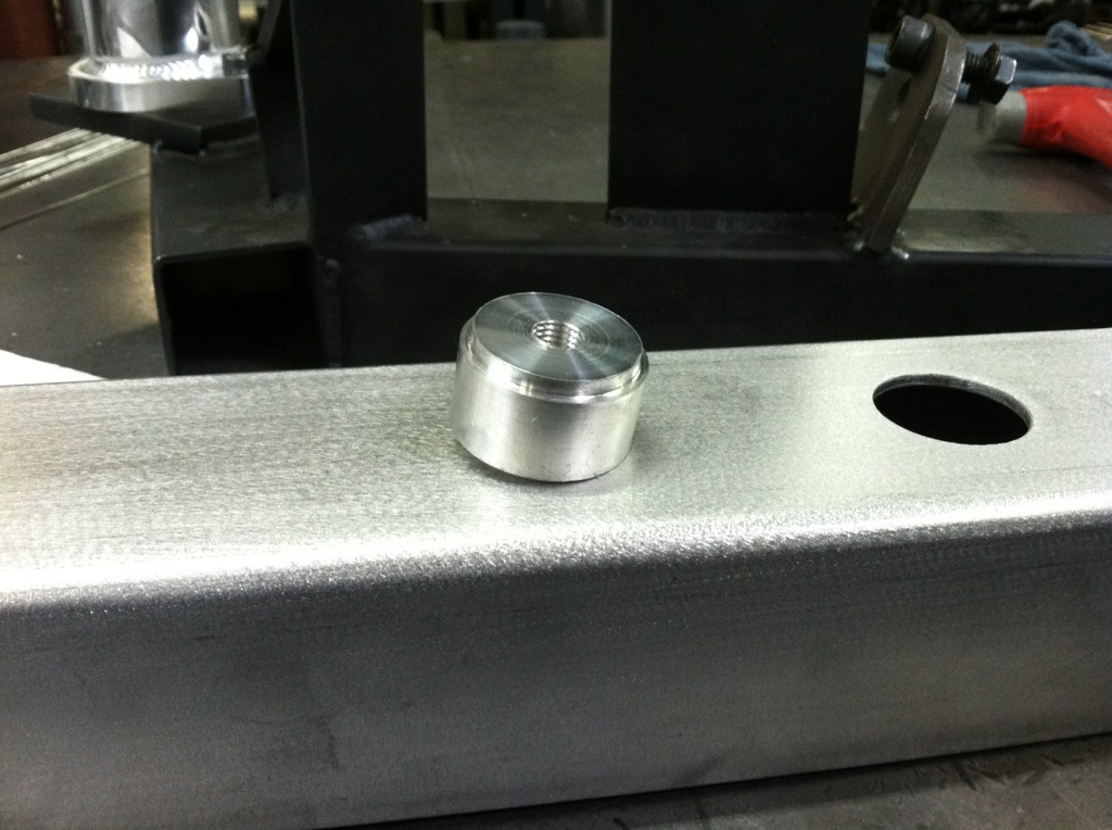

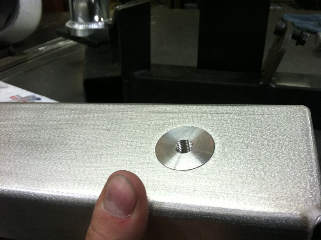

Some more work on this setup. Should be just about finished after tomorrow.
Old Jan 13, 2013 | 12:49 AM
  #398
So this is to replace the oil line under the turbo with a hard line?
Tigwerks Oil Drain for 02-11 Subaru Import Image Racing
Old Jan 13, 2013 | 07:36 AM
  #399
kmurphy's Avatar
Posts: 970
From: roseville, ca
Car Info: 06 obp sti
Either by making a hard line or using a soft line setup with AN fittings. Made because I hated routing the oil line on rotated turbo setups with that factory hard line. Now I can point the line towards the turbo directly out of the block and have a nicely routed line that's not on the verge of kinking, and its easy to install.

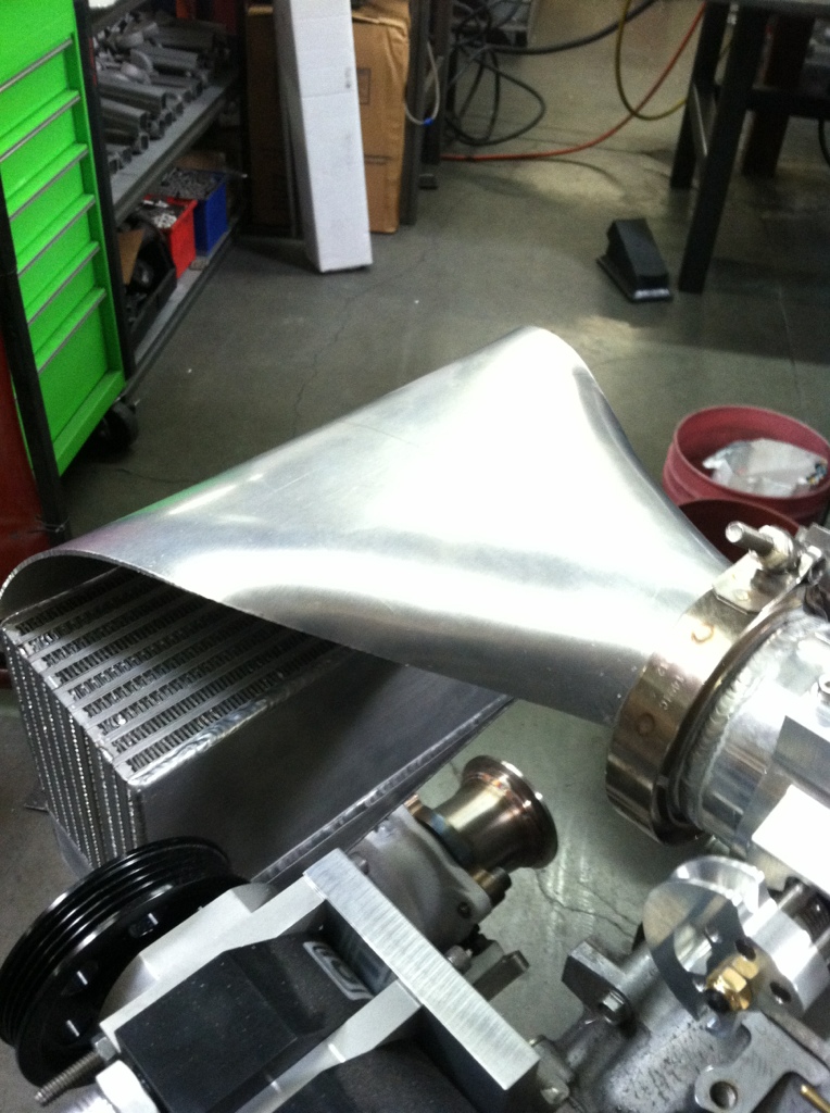

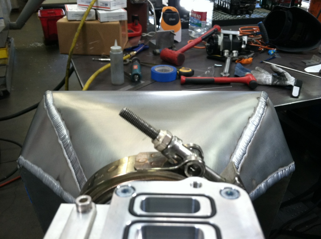

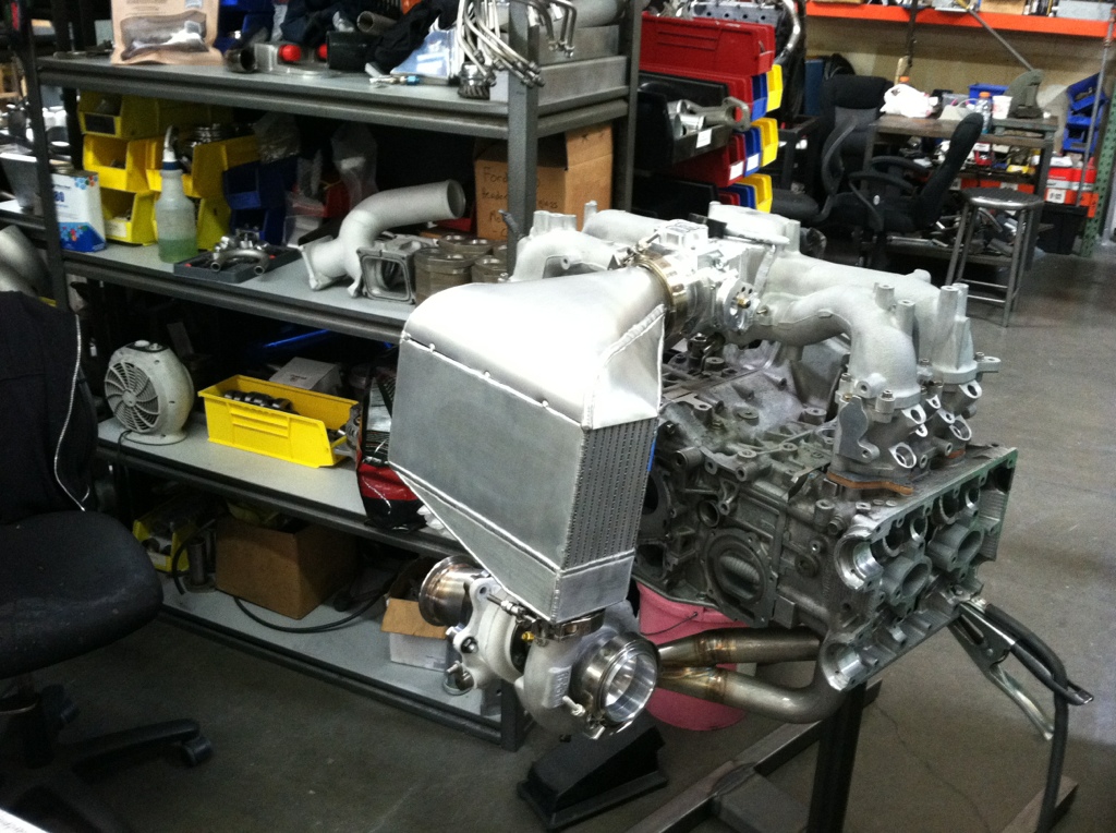

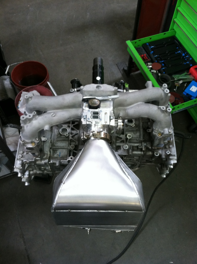

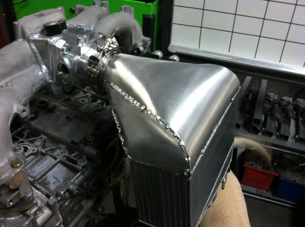

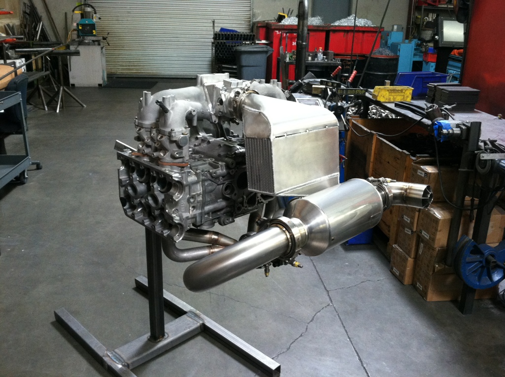

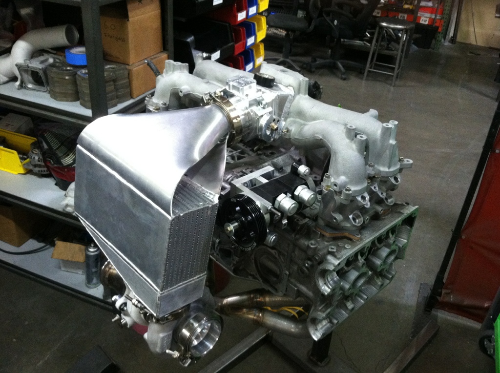

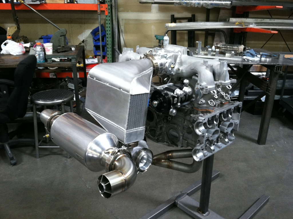

Intercooler hard stuff is done. Down hill from here with the easy stuff then shipping it out to New Mexico to the owner.
Old Jan 13, 2013 | 08:12 PM
  #405
kmurphy's Avatar
Posts: 970
From: roseville, ca
And a couple shots with the exhaust mounted up to get a clearer picture of the entire setup.
