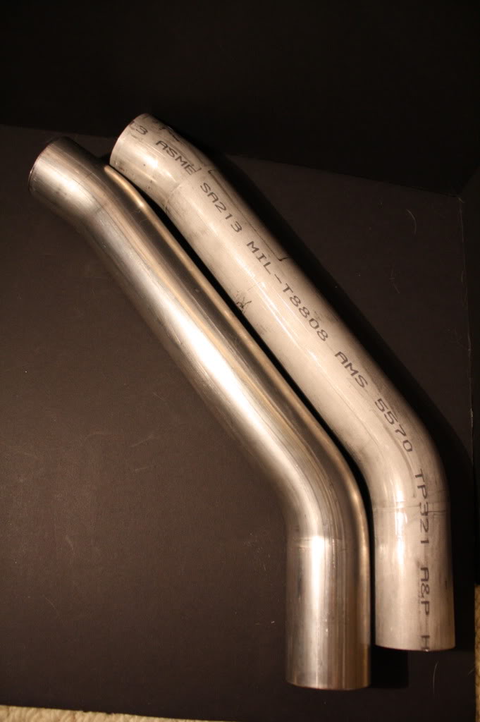

So here is a quick pic, obviously mil spec 321 stainless on the right and inconel 625 on the left. The 321 was also very expensive...usually 2"x.065" 321 costs me around $20 a ft, but this stuff is 2 1/8"x.065" and costs $60 a ft. The 2 1/8" being an odd ball size and usually found in .049" due to it being mainly for aerospace use and thinner wall sizes are more popular. Took about 2 weeks of calling around for it and finally had some shipped in from florida.
Really nothing that special to look at, could easily get mixed up with some stainless and not even know it til you tried to weld it. This stuff is very different welding wise compared to stainless. Luckily I have some 625 filler rod from my last job welding aircraft exhausts because that stuff costs about $60 a pound.

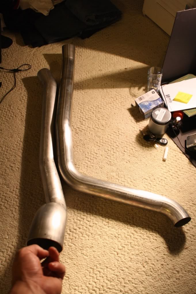

Picked up a stack of mandrel bent downpipes today, filled my entire back seat. 12-304/.065" and 5-321/.049" downpipes. The thin wall 321 dp has a noticable weight savings from the 304 setup. the 321 dp is the grey/dull setup and the one on the floor is the 304. same layout just different material and wall thickness.

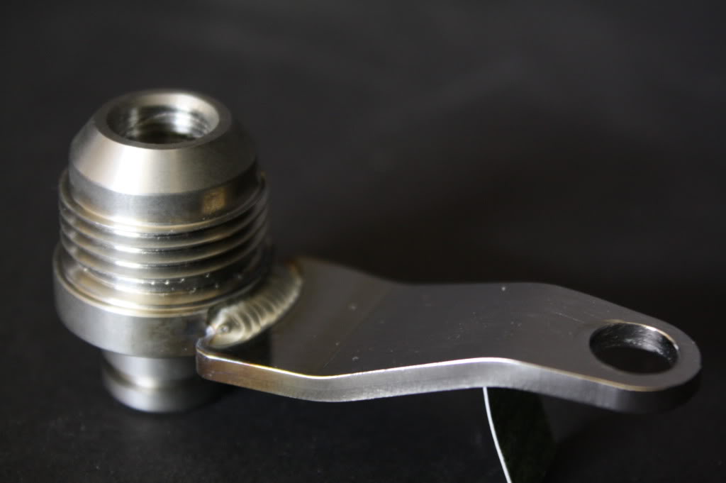

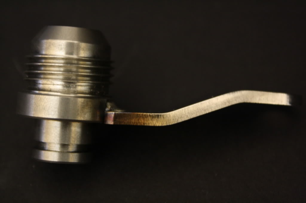

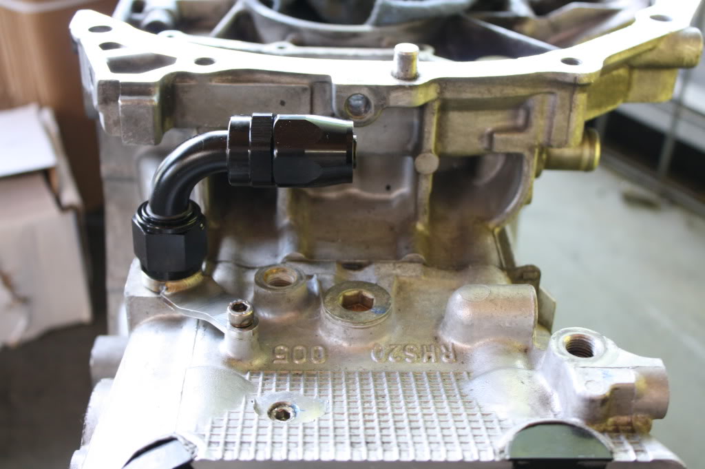

and actual part-
Old Jun 29, 2011 | 01:13 PM
kmurphy's Avatar
Posts: 970
From: roseville, ca
Car Info: 06 obp sti

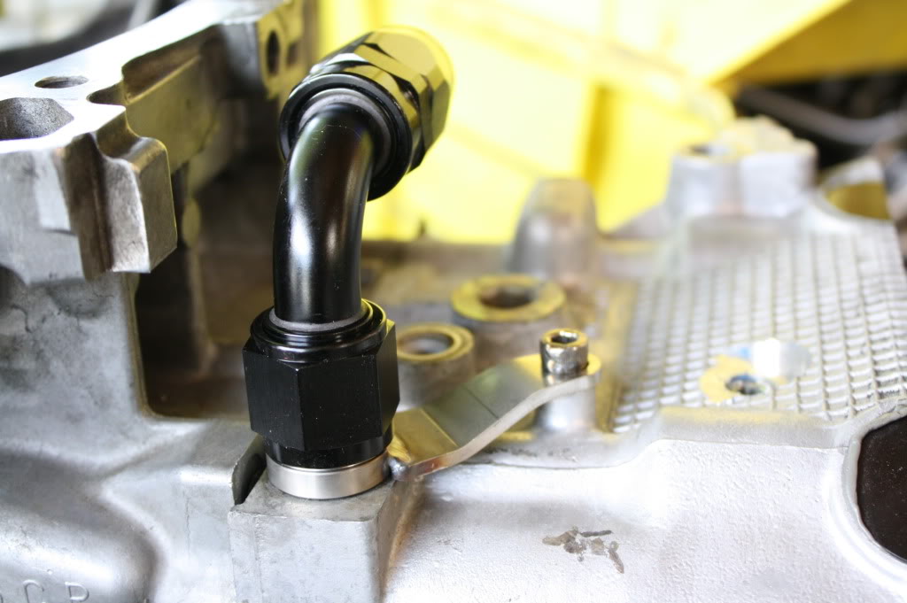

And installed-
