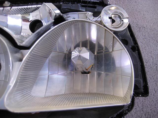

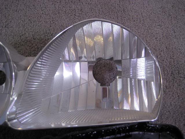

I have the factory HID's on my wife's Forester. They are not in a projector housing. They look like a typical Halogen reflector style, but the reflector in the HID ones are slightly different than the Halogen to make sure you don't blind people.

the 05 STi had HIDs but without projectors
HIDs not always need projectors to work correctly, but they DO need the proper cutoff as not to blind everyone.
don't just jump to a conclusion that someone with HIDs and no projectors are an *******.

'04 WRX on the top, '04 STI on the bottom.
Not the same.
Other cars with HID reflector optics: Escalades, IS300s, Nissan Maximas and Acura TLs.
