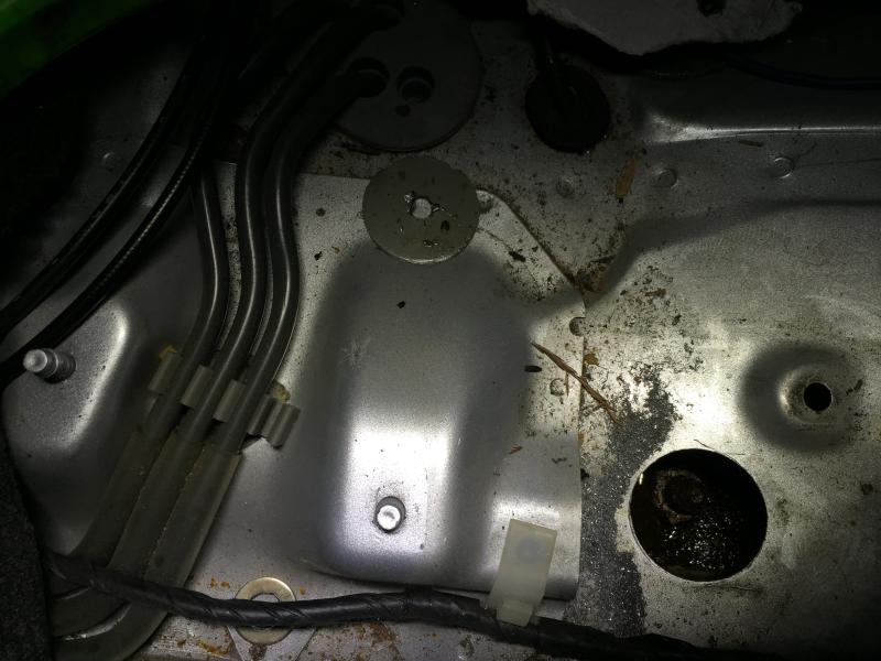

Bought a 1.5" hole saw & got to here tonight:
You can see the snapped nut through the hole, gotta cut one more next to it, then one for the front nut, which sucks because it needs to go right through that thicker, formed piece of sheet metal to the left (where it's scratched up is where the hole needs to be drilled......which sucks).
