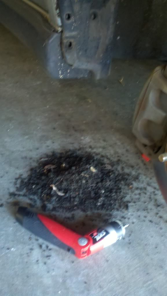

Yeah, no kidding with the dirt. When I did my RA flaps I got a LOT of dirt out of the fender too. Fozzy wasn't as bad, but was still a lot. At least 1lb per side.

lol, same with me on the dirt. Amazed at how much collected in there.
