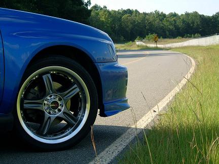

Enkei DM-5 looks exactly like that. I've got 18x7.5 Tenzo's on my wrx with a 42 offset and i think it fits perfectly on my wrx.

Originally posted by chxh8me
what are the affects of runnin wheels with an improper offset?
Worn wheel bearings, bad alignment, and weird bump steer characteristics. It's highly inadvisable.

I think stock offset is 48. I have the 17's in that wheel and it is a 46 offset. They fit well on the car. I think they are knock offs of the volk rims but i cannot affored em right now. Maybe later. I picked these up for $450.
