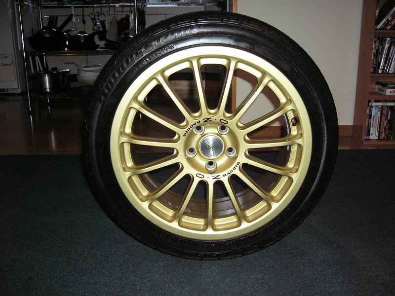

Question How to remove wheel weight residue
I just picked up a nice set of OZ Superturismo Evolutions at a steal of a price. They are in great condition, with the exception that there is a lot of residual adhesive from previously placed stick-on wheel weights left on them. I tried using Goo-Gone combined with scraping at it using a plastic putty knife, and that doesn't work. Does anybody have any method that has worked for them in the past? They are gold in color, so the black residue really stands out. I don't want to try anything too abrasive. Any ideas would help!

WD-40. Just reach over to the shelf, I am sure you have it. Works on sticker gum, badge ka-ka and REALLY works wonders for cleaning sport bike rims :-)

I think I have always had a prejudice against WD-40, but it did work like a charm! I just let it soak for about 15 minutes, used a razor blade to scrape off the remaining adhesive, and then used a corner of a dish sponge to get the remaining residue. Can't even tell it was there. Thanks for the advice!
I was actually told afterwards by a friend (who rides bikes) that Goo-Gone can actually strip paint whereas WD40 doesnt. Who knew?
