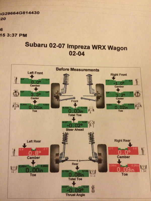

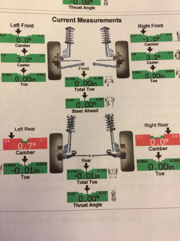

Just got my car aligned I think I have a bad tire cause it's still pulling to the right but it also still pulls to the left randomly. I can't get this f***ing car just to go straight. Do these measurements look right ? I see the left rear is at .7 while the right is .0? Any info would be much appreciated

camber should be negative on the driver side too

For the fronts driver side. You have a -1 degree difference from the front driver side vs the front passenger side. I would get that evened out. Its obvious that this tech just adjusted things "within spec".
As for the rears, unless you have coilovers with camber plates or rear camber bolts, the rear camber is not adjustable.
Can you post the specs prior to adjustment?

For the fronts driver side. You have a -1 degree difference from the front driver side vs the front passenger side. I would get that evened out. Its obvious that this tech just adjusted things "within spec". As for the rears, unless you have coilovers with camber plates or rear camber bolts, the rear camber is not adjustable. Can you post the specs prior to adjustment?
It's almost identical which is why I think I still have this problem. so sick of this car pulling its not even funny. I have replaced the steering rack with sti, added whiteline bushings, also have ohlin FPS with King springs and 22mm whiteline sway bars this car should be able to steer straight, or so I was hoping. It will randomly pull to the left then all of a sudden it's to the right, just makes no sense.

It seems that they did the bare minimum of adjustment and just took your money since things were kept "within the green field".
For the fronts, it only looks as if they zero'd out the toe for you but neglected to adjust and even out the front camber. I don't really favor having 0 camber in the front at all. Especially when you have a -1 degree of difference on one side, that will definitely give you that on sided veer that you mentioned.
Same goes for the rear, it seems like they just zero'd out the toe also. Cant adjust rear camber as I previous stated, unless you have aftermarket adjusting counter-parts.
The rear camber shouldnt be that positive though, it should be negative with factory spec. But previously you also mentioned that you added some suspension parts, Your new Ohlin struts and king springs ( assuming these are lift springs?) along with your stiffer rear sway bar may have raised the rear in which reduced the negative camber and gave you a more zero to positive camber settlement. If this is the case though, I do recommend that you obtain some rear camber bolts so that the next shop you take it to can dial out the rear camber for you and give you a little more negative camber. Having that much neutral to positive camber in the rear can also make your car twitchy and not as planted during rotation and maneuvering.
To be honest, while those alignment specs may be neutral, I wouldn't consider them very safe. At least in my opinion for handling.
Also Id like to mention that out of all the mods you have done, they wouldn't necessarily adjust your directional veering problem on the road. The condition and wear of the tires along with your alignment specs is what will determine how your car rides along a surface. Of course raising and lowering your vehicle will also adjust the alignment specs, but that situation is a little more detailed lol.
